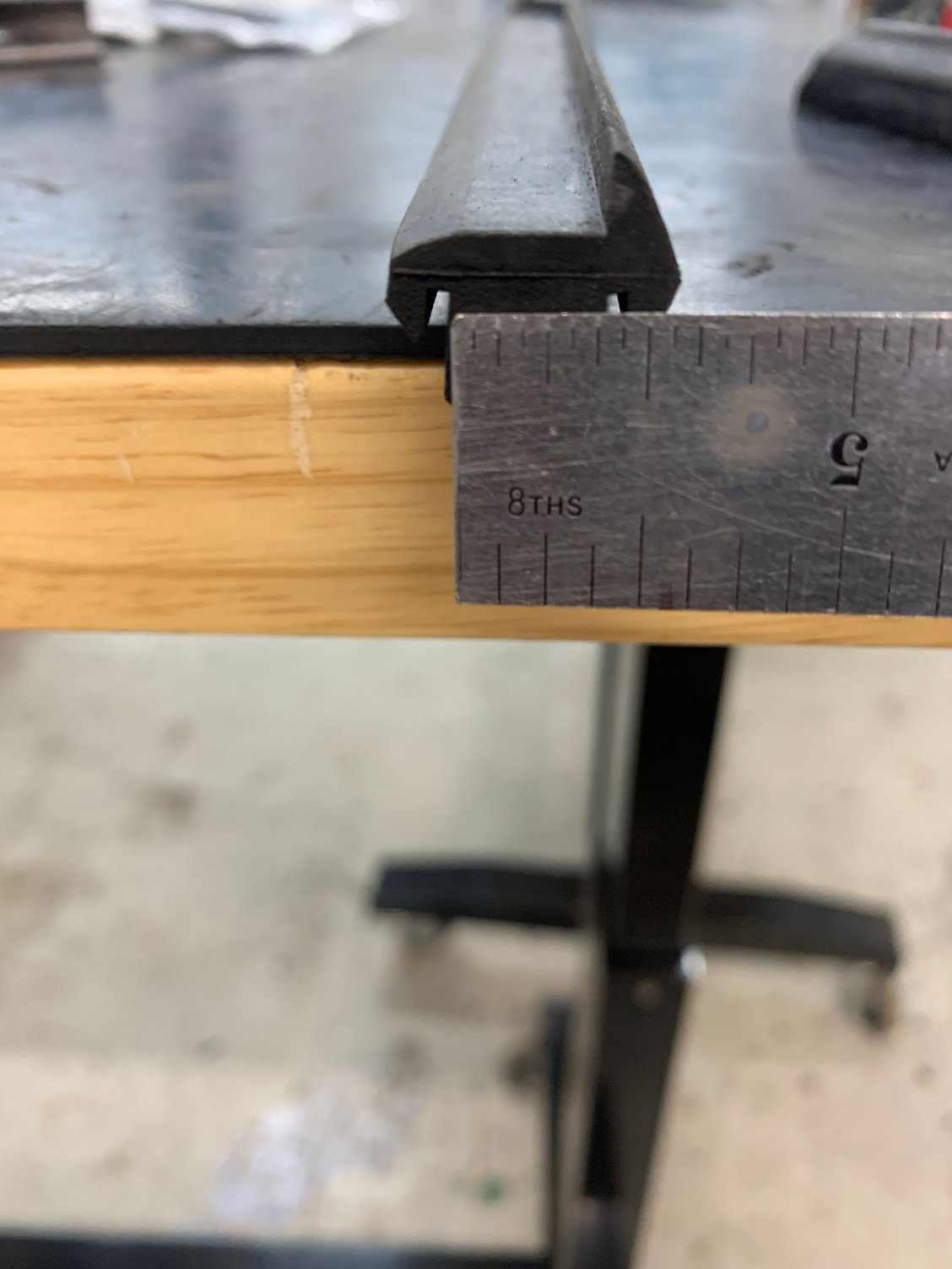

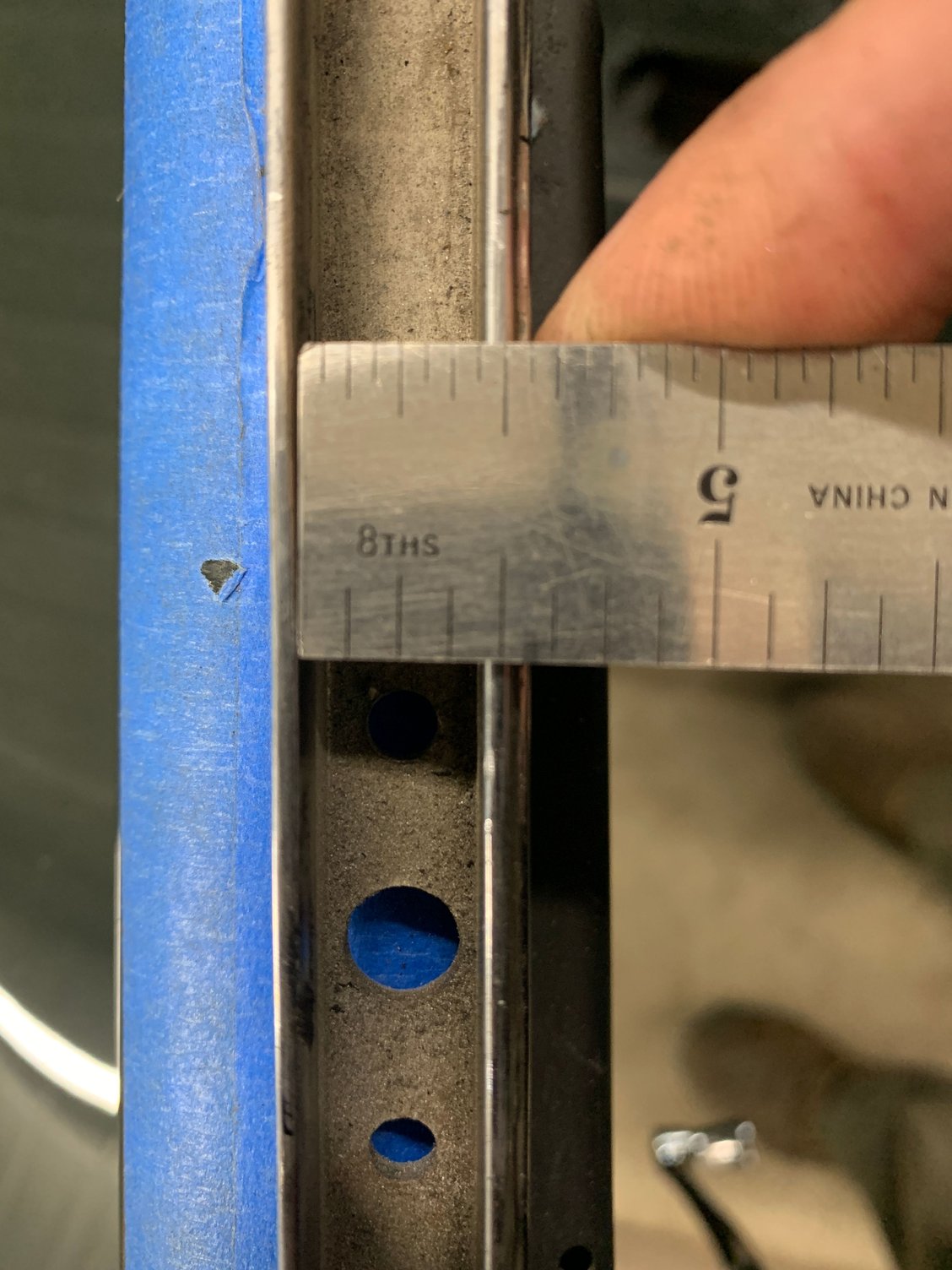

I've run across a problem fitting the rubber trim I ordered my from 1/4 light windows. Supplied rubber has a width of 3/8" or about10mm. Window track is 7/16" or about11mm. The trim will not seat properly in the track, it keeps riding up out of it. And the grooves in the trim that sit over the edge of the window are too narrow. I've tried Moss and SNG for trim to no avail. Suppliers response is this is what's available. Any ideas?
