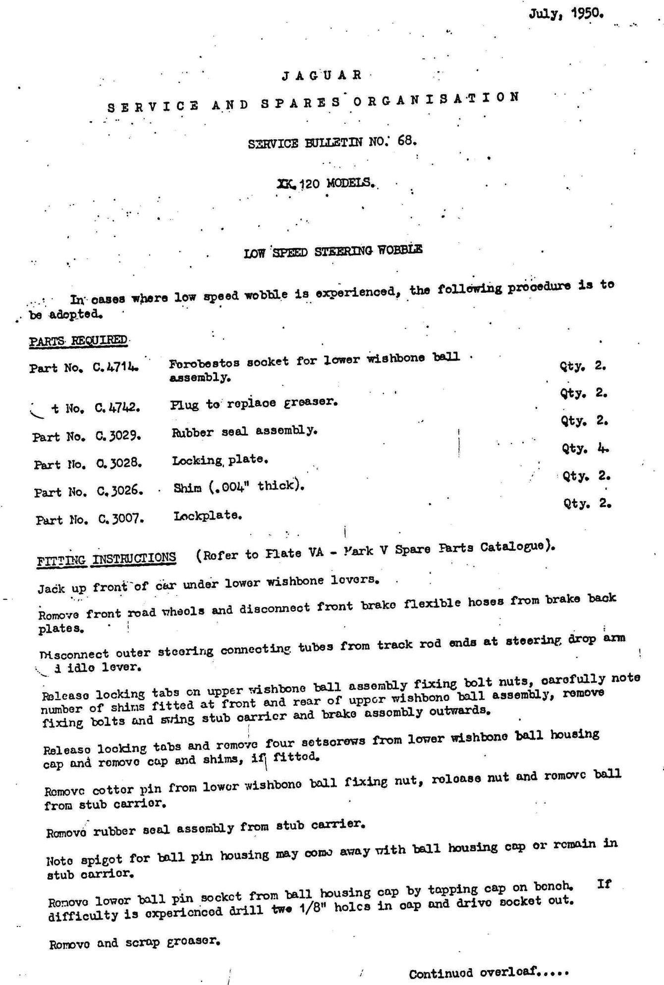

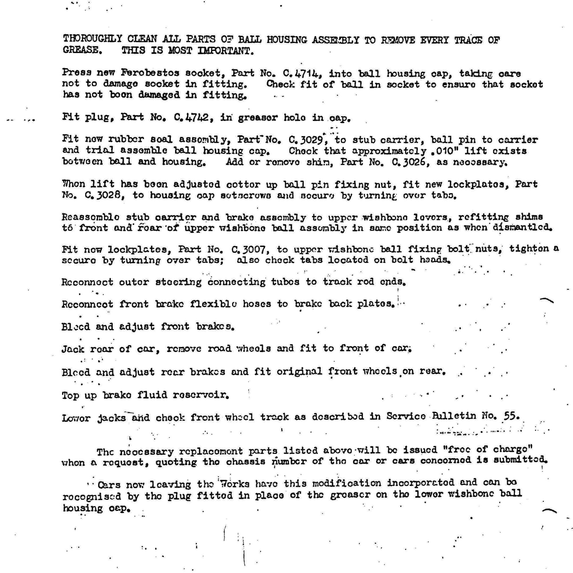

Also - it was recommended to me, and it has worked for over a year now, to make this change (note especially that ball joints go in DRY - *NO* grease) and to tighten up the ball joints to only .002-.003" float. As a result, ball joints will likely be a routine maintenance item.
360gtracer, Thank you for the service bulletin. Since my car was built in December 1953, I believe the changes to the suspension were incorporated into the car. I will check to see if the cap or plug on the bottome. I am pretty sure there is no grease fitting. I will check. Thanks for response. RickW
