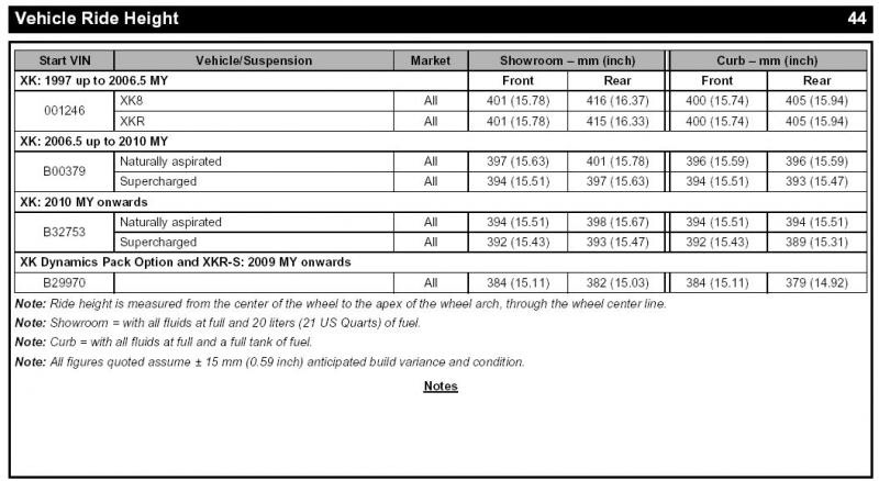

Do you mean to the apex of the wheel arch?
Old Dec 25, 2014 | 03:06 AM
JagNoir's Avatar
Joined: Jul 2014
Posts: 241
Likes: 36
From: Denmark
Yes he does. The highest point on the curvature.
