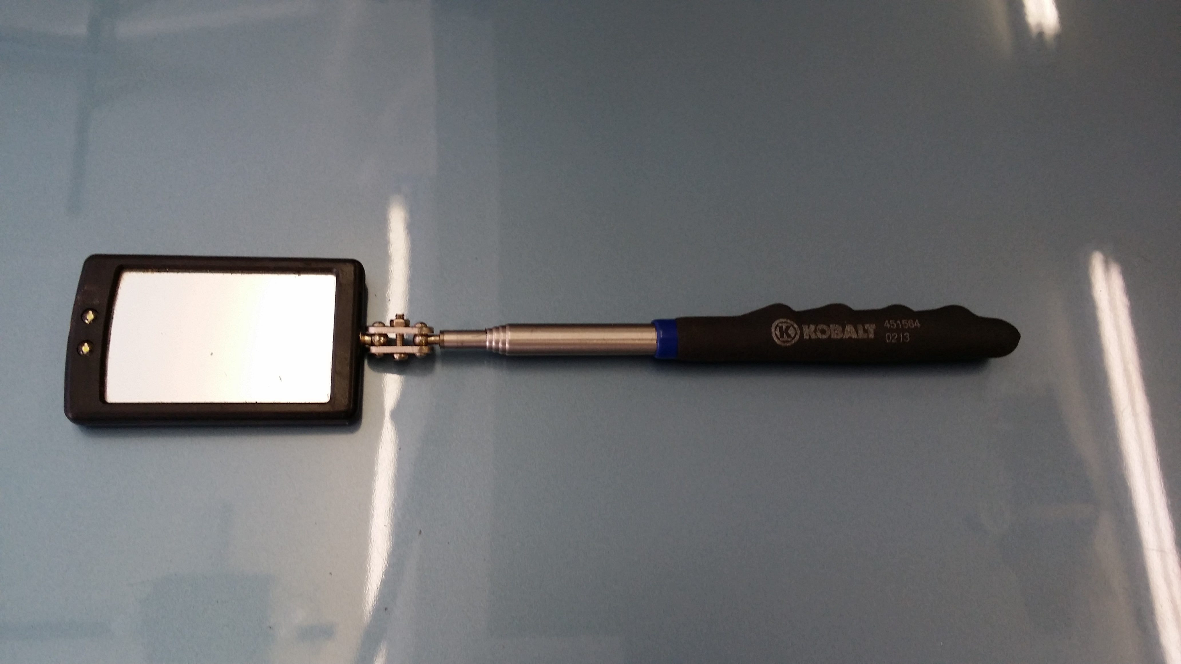

After digging some, I've determined that my 02 was rolled off the line in September of 01 number A25845 or the 1649th xkr made for model year 02. The engine was completed on September 7th of 01 which would indicate that it has the second generation timing chains that are "supposed" to last longer ?? BTW my 02 has just under 50k miles. So now what should I be looking forward as must dos ??? I will be doing the 50k service myself. Know I need to buy a code reader as recommended: Actron CP9185 going for $99 on Amazon.. Do I need any other special wires ??? BTW, I was able to somewhat easily find and copy the engine number by looking up into the engine from underneath between the steering rack and some other pipes where I could see the first 5 or 6 numbers. Then I used the small workshop mirror (shown on the attached photo) to copy the last 3 or 4 numbers. Forgot where I bought the mirror but it has come in handy over the years and has its own light.
