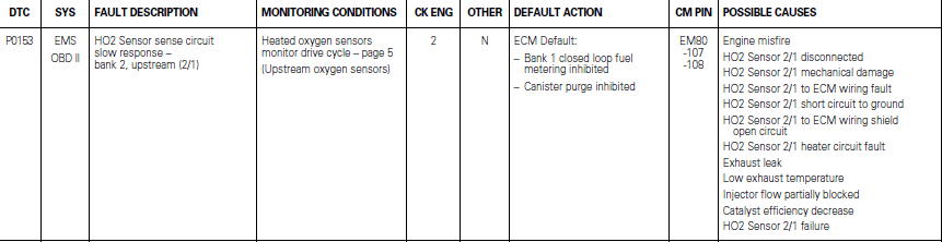

last fill I put in MIDDLE grade gas and used most of the tank. Right before laving for TN last week the car threw a CHECK ENG. Arrrrrg, I was like this damn car, first real 6.5 hour drive each way and it does this crap. It's a sign? So I pulled codes real quick and it was showing P0153 code. Which could be many things including incorrect gas. Is this car THAT sensitive to pop the code after being run on mid octane for about a half tank? I cleared the code and and 13 hours of driving later on the correct gas it has not came back.

Didn't you have a HO2 issue recently ? Loose pin I think?

I have a wire that I pulled out by mistake when I was doing my octopus home. I put it back in, but has came out a few times and caused a diff code then this one. The code never came back.
The gas I put in the car was a middle grade/octane gas, not the top grade I always put in it other then this one fill up.
Ho2 slow response? Could that be my wire that for what ever reason did not have a good connection at the moment?

From reading posts for 3 years I know many use 89 rating without a problem. I know you have the torque app, put it on and check your fuel trims.

oh well my code has not returned. I have a 9 year old battery, perhaps that is the cause or the lose wire on the O2 plug that I have had to push back it had a moment of week connection.
