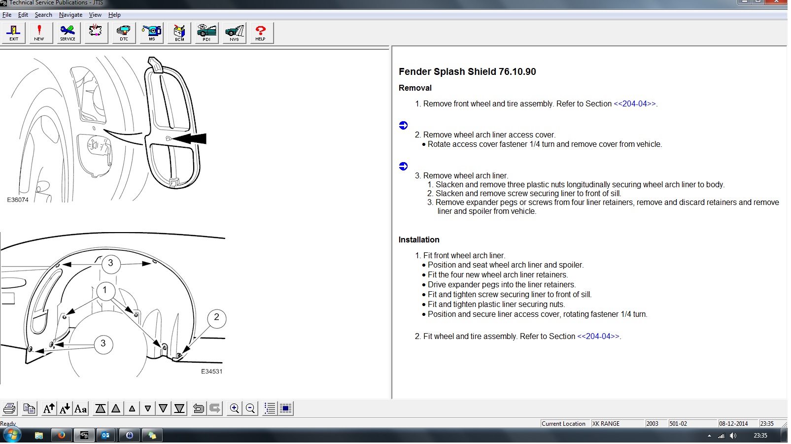

Old Dec 8, 2014 | 05:40 PM
Originally Posted by brgjag
that looks like a biatch to get too.
It's not that bad. Here's the section from JTIS:
You'll need to remove the liner (splash shield) if you ever have to change upper wishbone bushes.
Attached Thumbnails 03, how long it take to bleed/top reservoir tank?-wheelarch-liner.jpg
