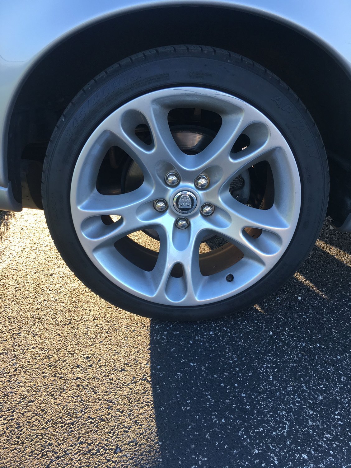

Here are some pics. They're generally in pretty good shape, all 4 were refurbished about 5 years ago.
Thanks. Those are the 19" Apollo style. I think they were introduced in 2003. I have them on my 2004.
They are the best 19" wheel IMHO. Definitely worth saving if you can.
If you decide to replace them I would gladly take them off your hands. I bet I could salvage at least one to use as a good full size spare.
