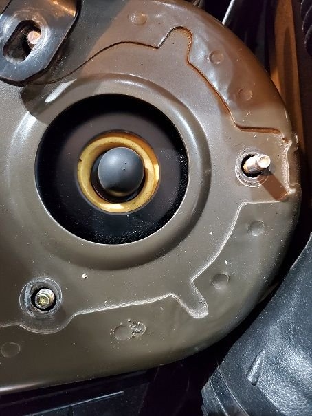

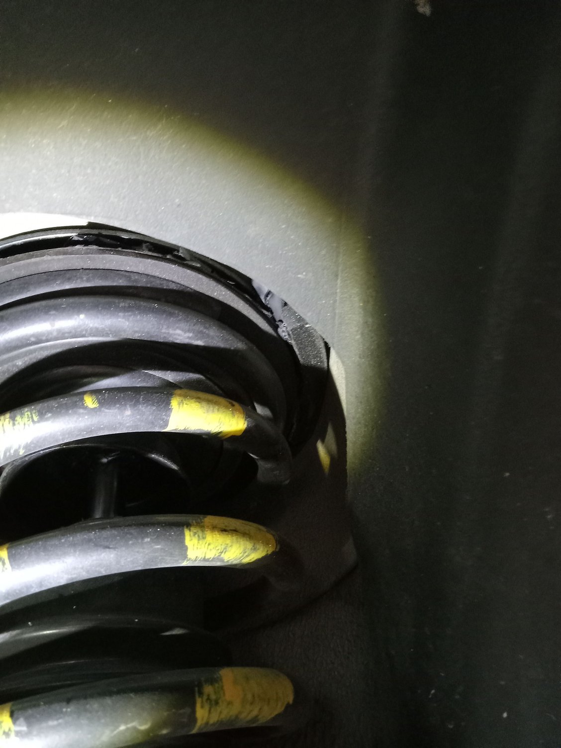

I keep eating thru shock mounts, have replace them twice and last time I use OEM parts. Found the ft right shock bolt off center yester. Jacked the car up and remove tire for inspection. Found the black rubber insulator destroyed hanging in pc's. Any idea why I'm eating thru these. The OEM set have less than 15K miles on them.
If Wayne can't help drop me a PM.
You say last one was OEM, are you sure it was, or were you lied to. A lot of the yellow material mounts being sold now, they are not much more than a yearly subscription scheme.

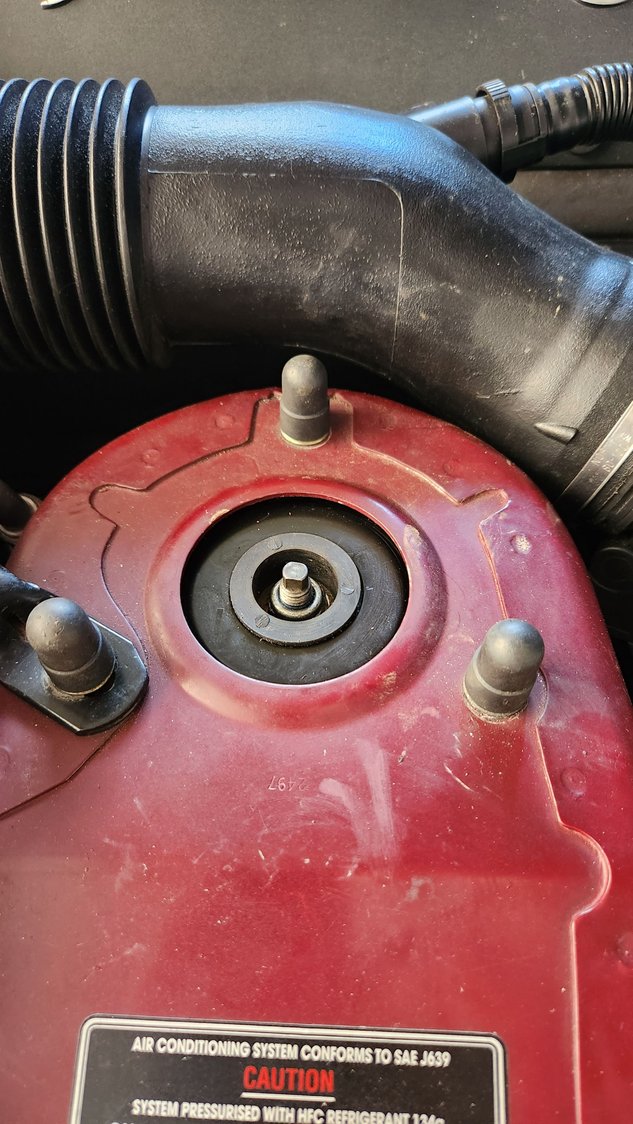

I, too, noticed the right front bolt was off on my shock. I'd been over a rough stretch of road and felt some "juddering". I'd just replaced the front shocks and mounts a couple months ago. I jacked it up and everything seemed tight with no visible damage, When I removed the top bolts I noticed that the diameter of the bolts was smaller than the holes in the frame (see pic).
The holes are not elongated but I'm sure if I don't take action soon, they will be. Judging from the paint underneath the nuts there has been little, if any, movement so still not convinced that's what caused the juddering. I don't have a clue why this didn't set off alarm bells in my head when I installed them, must have been half asleep I guess.
My question is...
are there any bushings or tapered nuts (like lug nuts) that could fix this issue or am I doomed to buy a new set of shock mounts, rent a spring compressor, etc. etc. I'm open fo suggestions. Thanks.
My question is...
The stud to hole clearance is normal and has nothing to do with your problem.
The problem is mostly down to that yellow crap in your mount. I have no idea why this one particular brand of front mount still has any market share.
Fitting these is akin to an annual subscription.
