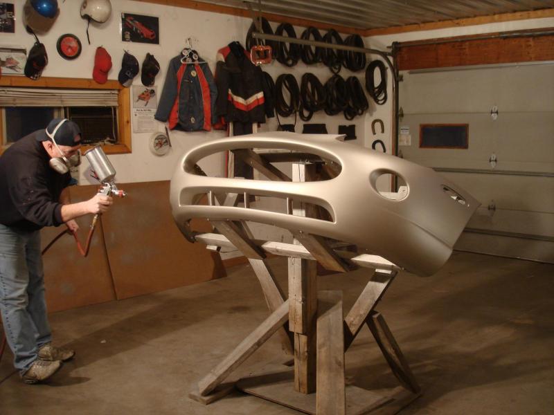

Just got done putting the last of 3 coats of the base color on. I will be spraying the clear coat in the morning with the flex additive in it. The bumper will also get 3 good coats of clear. The bumper will have to sit for a week and then I will color sand it and buff it out. Then it will be time to put it on the car. I will post pictures every step of the way.

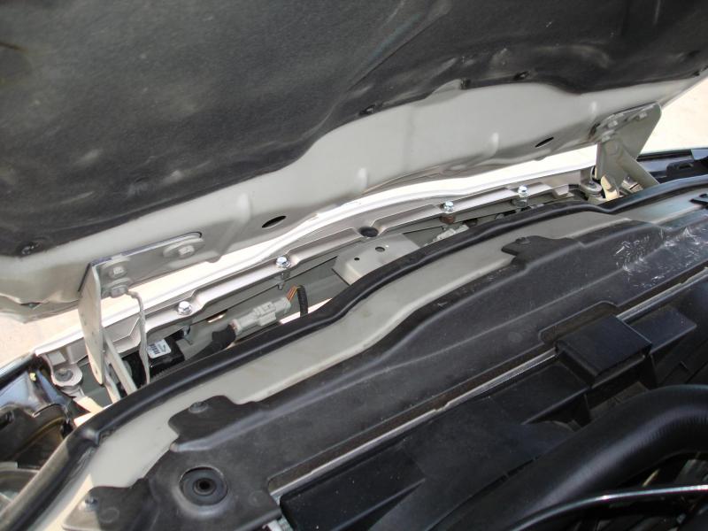

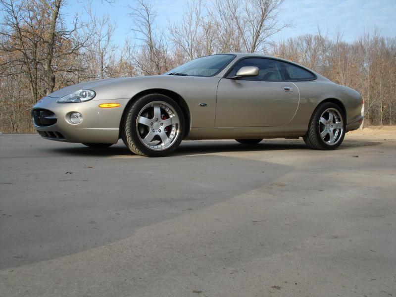

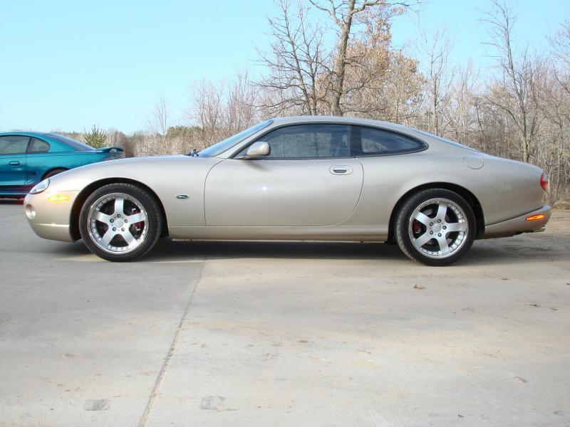

Sorry about not getting some pictures up sooner. Here are a few for now.

That nose looks good on that car. Great job! Looks like a good match and neat job.
