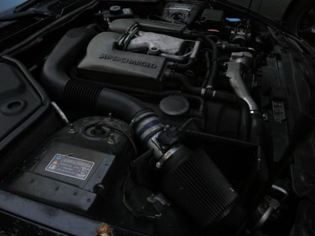

*There is a Custom made K&N Open air filter installed by previous owner.
the K&N filter

If you got the original air box put that back ..those filters are crap ..I know I lived in the Australian dustbowl outback. Also you dont take in cold air from under the wing.

Unfortunately the original air box did not come with the car, I could not find it in the trunk but it's not really that big of a deal for me as it is done in an adequate manner. I do know that open / cold air intake does not do much to a "performance" car but I think it looks quite fitting for now.

Like someone already said the OEM intake is a cold air intake, what you have there is essentially a hot air intake.

I'm not quite sure how it is a hot air intake system, it does retain the heatshield and it looks a little bit less restrictive than the OE box, I'm pretty sure it is just as efficient maybe a little bit under from the OE box as the piping is not shortened (unlike short-rams) as it is still using the OE piping as well. I'm planning to add an extra layer of heatshield around it to make it a little bit better.
I have done a couple hot/warm air intake installation on some older cars and I can assure that they are very differently set up.

I'm no expert but the concensus seems to be that the OEM air intake is a good designs as it draws air directly from outside via the wheel arch. The aftermarket air intakes all tend to draw air from the engine bay which gets very hot in ours cars esspecially as some of us have superchargers as do I. The intercooler system already has a hard time dealing wth the charge heat so it's making the problem worse if you already start off with higher intake temps. You can improve flow in the intake by replacing th eintake pipe that goes directly into the throttle body but it seems to be best to leave the OEM filter box alone otherwise. An improves intercooler coolant pump and increased radiator size is a good idea though.

My XK8 had that same set up when I got it. Hated the suction sound and it just looked tacky. Got a used assy. on Ebay. I think I still have the take off, if anyone wants it they can have it for shipping cost.

the K&N aftermarket filters such as you have are considered “hot” intakes simply because the air is pulled in directly from the engine bay, which is way too hot for these cars.
the stock system routes the incoming air from the wheel well area, where is much cooler than the engine bay.
if one has to have a K&N filter (I don’t know why), then get the one that fits inside the stock air filter box so it retains the stock plumbing arrangement. As mentioned, you can find the stock air boxes on eBay all the time, I might even have a spare one, I’d have to look to be sure…..
Seriously, after you get the leak fixed, consider getting rid of the K&N cone filter. This is one instance where the Jaguar engineers did it right (with the cold air source). And the aftermarket cone filters are a step in the wrong direction.

Ah I see what you mean, later down the road I'm planning to make the car OE+ so I might get an airbox off of ebay but for now I'm more focused on fixing it up and getting it on the road. Thanks for the input.

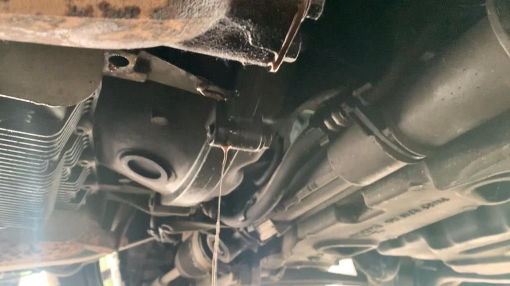

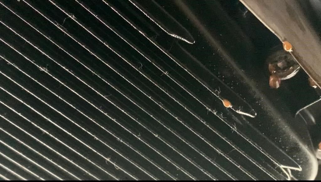

I recently bought 1 gal of ZEREX Dex-cool (I figured since it's compatible with WSS-M97B44-D) and tried topping off the XKR.
Once I started it up, it started dripping from 3 points, one of the points stopped but when I shut it down there is a stream of coolant leaking (see pict.)
The coolant stream
*located a little bit behind the first photo
Any ideas on what might be the cause?

Could be the valley hoses. Could also be the Norma connectors....
