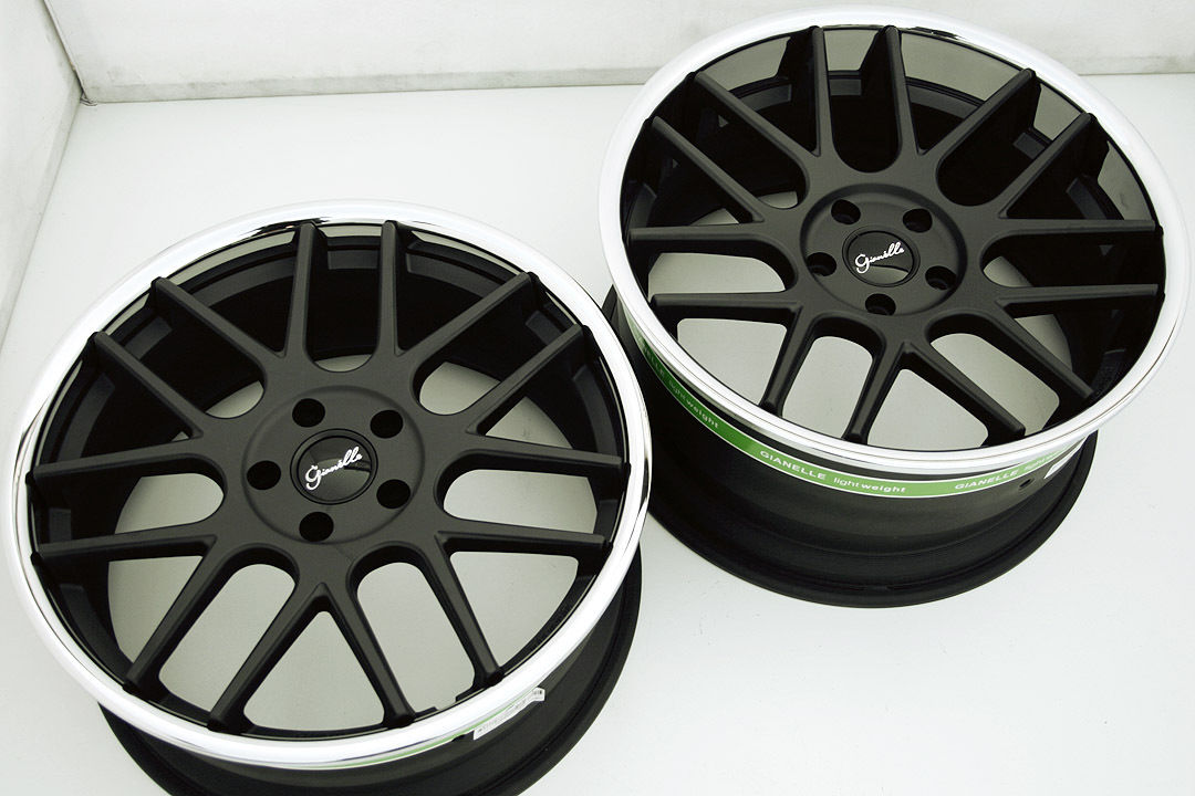

I know. I have a place by me that is willing to try rims on the car to see what fits as far as clearance of calipers etc. Im collecting as much info in regards to offsets I can find and tires size. That will help narrow it down. I kind of like this rim and they make it in the correct bolt pattern but unsure if hub bore is correct

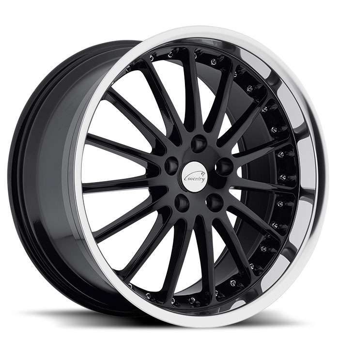

Hi Slowpoke, nice rims you found there and they should go well with your matte black car. Very reminiscent of the Perseus', which seem quite hard to find, at least on this side of the pond.
Have you checked out Coventry wheels? They are made to Jaguar specs and come in varying sizes. I'm thinking particularly of the Whitley's, although they're gloss black, not matte.
Good luck with Santa :-)
Attached Thumbnails 18's 19's or 20's?  Lowered...Help :O)-jaguar-wheels-rims-coventry-whitley-5-lugs-black-std-700.jpg

I LOVE the perseus. IF I could get a set Id redo the centers Matte black. I found some montreals locally but they don't do it for me. I love those Coventry wheels as well. They are on the list. I didn't want to go all black out on my car. I still like some chrome so a black center chrome or polished lip is what I'm after. Too much black takes away from the cars style in my opinion. Maybe it will be an after xmas xmass present. Don't want to rush it
they are exactly what I want for my xkr, do you have a link to these wheels and what offsets they come in ect

Sure Dr., it's all here:
Jaguar XK Wheels
