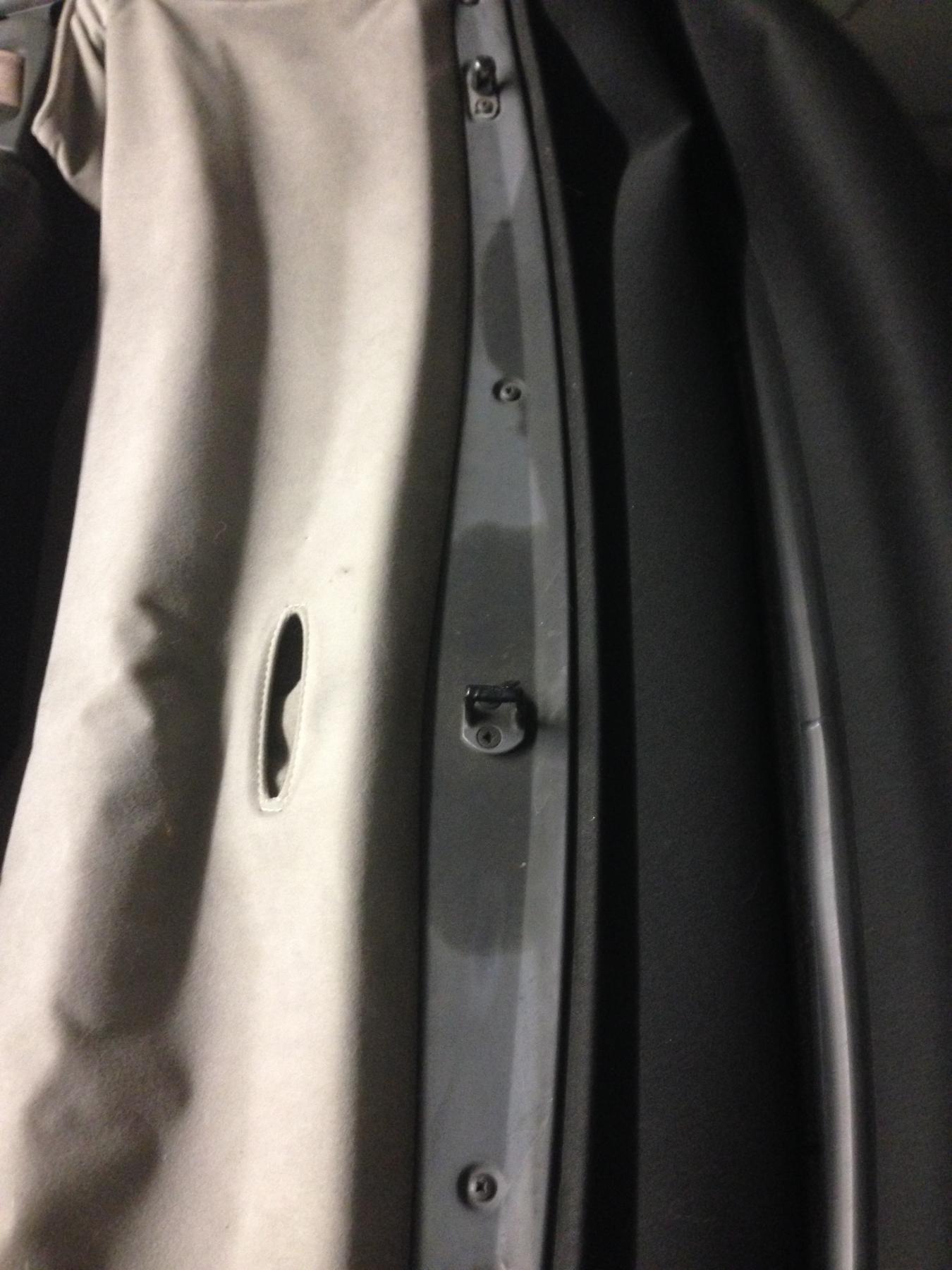

From your various videos (especially your last two) it appears that the latch is your remaining issue. That is probably the very toughest bit of hydraulic movement the system has to operate given the short amount of room it has to so little leverage over such a short distance.
As an aside it has been mentioned on other similar threads that a manual up or down can throw off the timing of the system due to the various micro-switches. I know when I had to refill my reservoir (to the lines indicated and not to the top) that the first attempt to raise it automatically did NOT work. I had to raise it manually (as I had lowered it manually previously) and then lower it automatically before everything would synchronize again.
Since you've lubed everything and it seemed to improve to some extent I'm still inclined to think you're having a pump pressure issue.
The sequence should be when putting the top down that the rear quarter windows go down FIRST, then the latch begins to open up with the top beginning shortly afterwards with the latch being fully open just as the roof latch needs to clear it. The top continues to the fully down position, the latch closes and you should then hear the chime make a single tone. When the top goes back up again the two door windows should first drop about 1/2" and then the top starts to go up as the latch begins to open. By the time the top gets there the latch should be fully open so the latch can grab it as it starts to close and pull the top down the rest of the way. It may appear to stall for a moment or two as the latch starts to pull down and then latches the top over the last little bit. At that point you should hear a single chime followed by the side windows and the rear quarter windows come up to the fully closed position.
I write all that even though you probably already know it just so we're singing from the same hymnal as they once used to say.
It is possible at this point that several more up and down cycle will re0snch everything but if the latch problem should persist I'd be trying to find a way to test the pumps maximum output pressure as I think the problem is there at this point.
Did you clean the piston of the hydraulic latch?
I am uploading two new videos, TOP-DOWN and TOP-UP, check those out under XK Convertible Top folder on photobucket
On Top Down I have to wait till the latch pin is almost at the point of stopping then I can push pretty hard on the top and it opens, the top at that point Springs open.
On TOP DOWN If I dont slow the top operation by letting off the button it will close faster than the latch can open. The last one should be done uploading in 2 minutes

I think! It is the shaft that is connected to the block that the hydraulic hoses are attached to.
I only saw that the last couple of times back in there when I had a light on it. I used a dielectric grease to lubricate it on a q-tip to get back in there.
A lithium or silicone grease maybe (I don't know what the seals are made of; it might influence what kind of grease to use.)
Here is what I used, I have some Liquid Wrench White Lithium.
If you use WD40 it will clean and lubricate for now then you can finish it with a good silicone spray. The seals are rubber "O" ring and a neoprene seal for the pressure. I suspect that the one seal is dry and or dislodged spraying it is just a bandaid repair.
Thanks Gus, I just tried operating it again to Open and the Pin is back like it was moving only a short amount. Considerable force to get it to unlatch and then it wouldn't close again.
I purchased this is March of 2014, 76K, top worked fine so that is my starting point. I was just looking at the Top Down and noticed these marks, looks like at one time it showered, would you agree? Its not wet now, but you rub your finger on it and get a slightly oily finger tip. I have looked over all connections and see no leaks.
