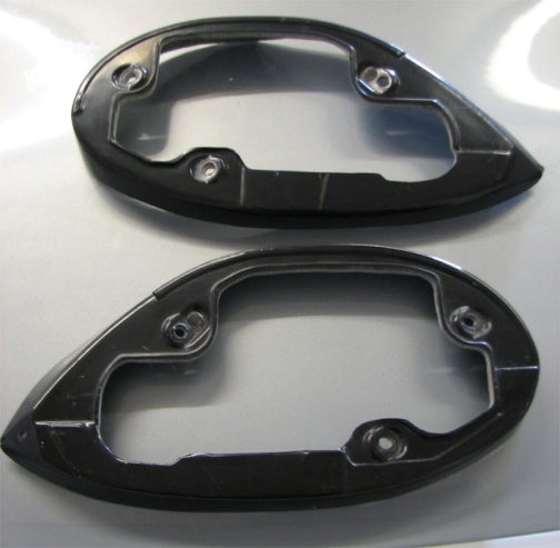

I followed the contact to find Paragon Design UK website full of amazing (and pricey) conversion options. They also offer the internal composite panels to properly fit in the updated rear jewel tail lights. Much easier project now...if I could find someone with cutting tool , hahah.
Anyway I thought I'd take a liberty and post couple pics of the actual aftermarket Paragon Design composite panels (priced within reason btw) below. Hope Paragon won't get mad for taking them from their copyright protected website .
Attached Thumbnails 1999 XK8 Coupe... modifying the rear lights.-image001.jpg   1999 XK8 Coupe... modifying the rear lights.-image003.jpg

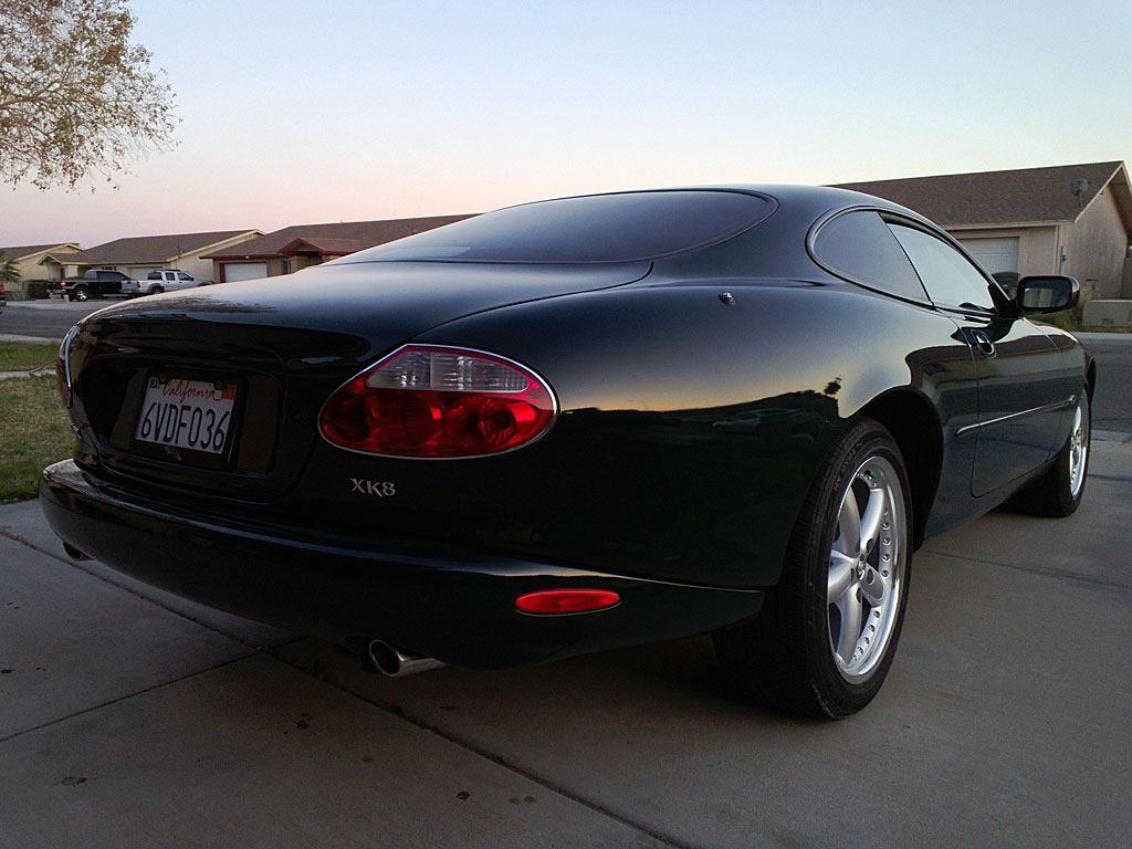

I may only add one thing, XKRacer. The rewiring Guidence was on my car inversed (Driver side in place of passenger and vice versa ). Also, I did not have an orange red wire as listed under passenger side (my driver side) instructions. The wire that accomplishes the same (side light) power is instead solid red . Best luck to all brave souls that are pondering this project. It's totally WORTH IT! Btw, all problems with bad ground or faulty light bulb messages are instantly the matter of past .
Before & After (I really tried hard to pick similar angle pic with same (dawn) ambience to it):
Attached Thumbnails 1999 XK8 Coupe... modifying the rear lights.-mr.bond_tloriginal1.jpg   1999 XK8 Coupe... modifying the rear lights.-mr.bond_tlupgrade1.jpg   1999 XK8 Coupe... modifying the rear lights.-mr.bond_tlupgrade2.jpg

I may only add one thing, XKRacer. The rewiring Guidence was on my car inversed (Driver side in place of passenger and vice versa ). Also, I did not have an orange red wire as listed under passenger side (my driver side) instructions. The wire that accomplishes the same (side light) power is instead solid red :
Good reason for that drivers side is on the right
There is a difference in the wiring on 2000 MY as that is when Jaguar were getting ready to bring out the facelift and maybe they ran out of looms for the earlier cars and instead of getting more made fitted 2001 looms instead..... Just my assumption
But we'll done.... Looks good.... Always say this is one of the best body mods to do
