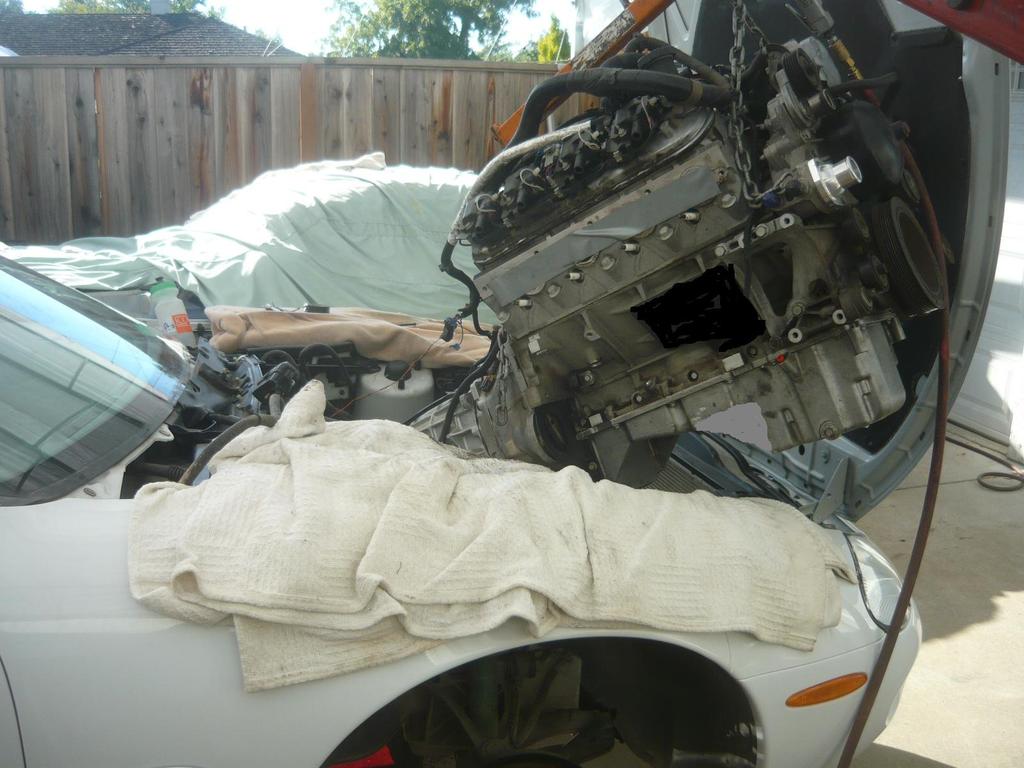

You may find this hard to believe, but on the last XK8 I worked on (a 98 convert) I removed the engine and trans together as a set from the top WITHOUT removing the hood. Disconnecting the hood struts and opening the hood further, to just beyond straight up position, gives plenty of access. I did take out the fans but left the radiator in place (I put a plywood board against the engine side of it to protect it from damage).
I put the front wheels on 4-5" high blocks and then push the cherry picker in from the left or right side, perpendicular to the side of the car. An engine tilter (load leveler) is the key to this.
And when the new LS1 and 6 speed manual transmission went in, it was the same thing- from the top. The hood has never been off this car......

I did it the same way on my 99 VDP......
