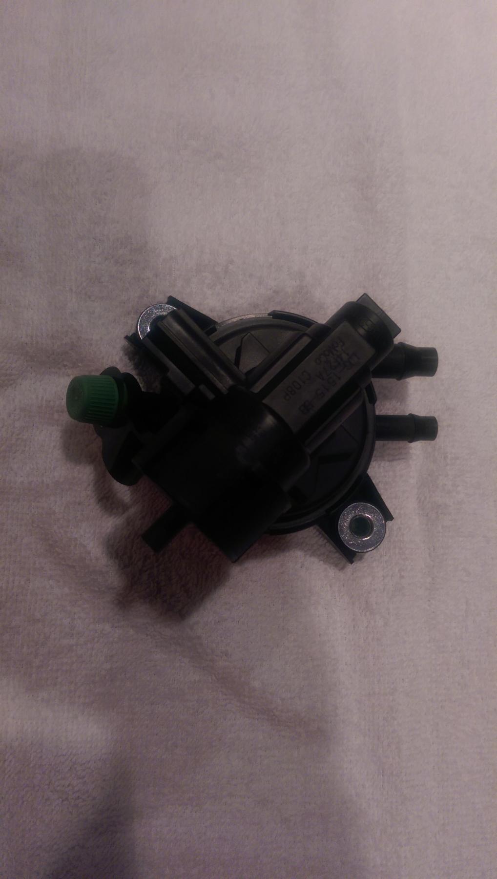

I just received my purge valve yesterday. Similar problem with less than 1/2 tank I'll smell fumes. There was no back pressure but this is the first FRU. Location is behind drivers side wheel liner, I'll be doing mine in a week or two.
