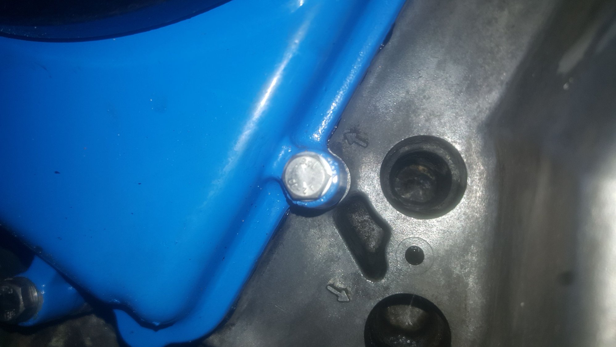

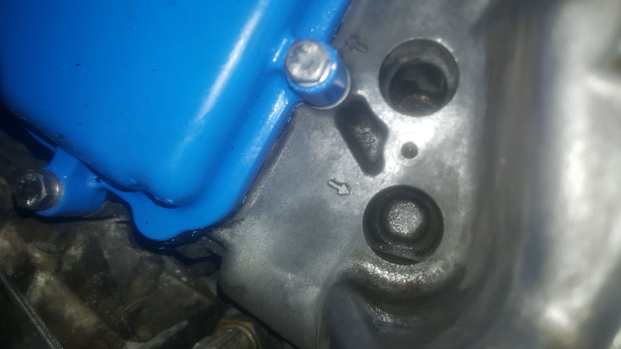

Did the 2000 or pre 2000 XK8s have no engine oil cooler?
I'm working on an engine that seems to have two blank ports, blanked off holes, at the front of the upper oil pan where my 2002 XK8 has a the same two holes (a bit larger in diameter) where I have two oil lines. One line out to the oil cooler in front of the rad,,, one return. The 2000 engine I have HAS the holes, bit they go no where. They go in about an inch then are basically closed off, blanked. Has a little hole where my 2002 has a threaded hole, smaller in diameter than the 2002, and unthreaded... I'm puzzled..
Did/does the 2000 or the pre 2000 XK8s not have an oil cooler?

Tomorrow I'll take a snap of what I'm looking at...
The 2002 cooler hoses don't/wouldn't fit, the diameter of the connects at the engine end are bigger than the orifices at the false holes of the 2000 motor. If the 2000 motor DOESN'T have the cooler it's only a relief,,, I'm in the middle of an engine swap and I got stopped in my tracks. I was thinking I was going to have to shell out $200 or more for the new hoses and maybe a cooler rad. Or that maybe the hoses and ports were somewhere different on the upper pan.
If there is no cooler set up, if it was an option one could elect at purchase,,, it's a good thing for me at this point. We'll see.
Some do, some don't. I have read of two members owning '97 cars that do: Vern as above and and one in the UK. My 98 doesn't. JEPC shows both throughout the MYs.
Probably the same casting for both, machined as appropriate then assigned a different part # for each flavour.

Originally Posted by michaelh
Some do, some don't. I have read of two member owning '97 cars who do: Vern as above and and one in the UK. My 98 doesn't. JEPC shows both throughout the MYs.
Thank you Mike and Z. Really.
I took this today. Like you said Mike, same casting. I took this today before pushing ahead. Car whipped my butt today, exhausted, but I intend on adding a little something about the swap in a thread I started a long long time ago when I was asking if the swap was possible.
