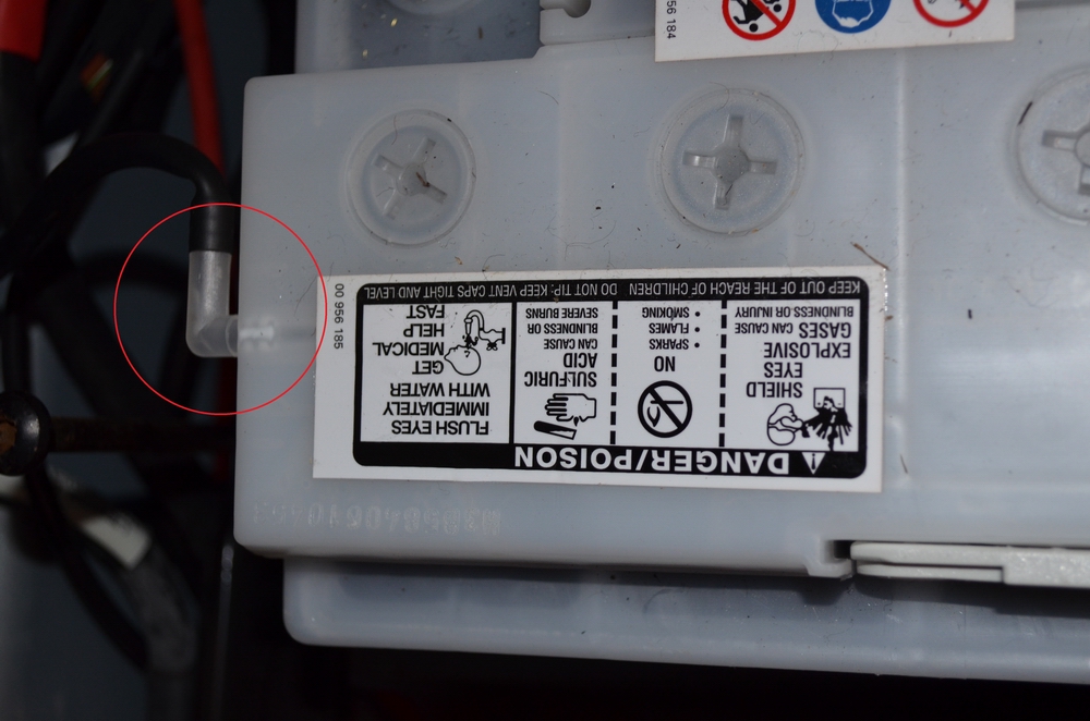

The battery must have a Vent (circled in red) at the +ve end next to the bulkhead:
The black plastic vent tube pushes onto this and passes through a grommet in the floor to vent beneath the vehicle.
As well as being the correct capacity, the battery should be the same or as near as the same physical dimensions as the original so the clamp holds it securely.
I expect a 'hard reset' could resolve a lot of the weird electrical issues you have listed.
Attachment 75123
