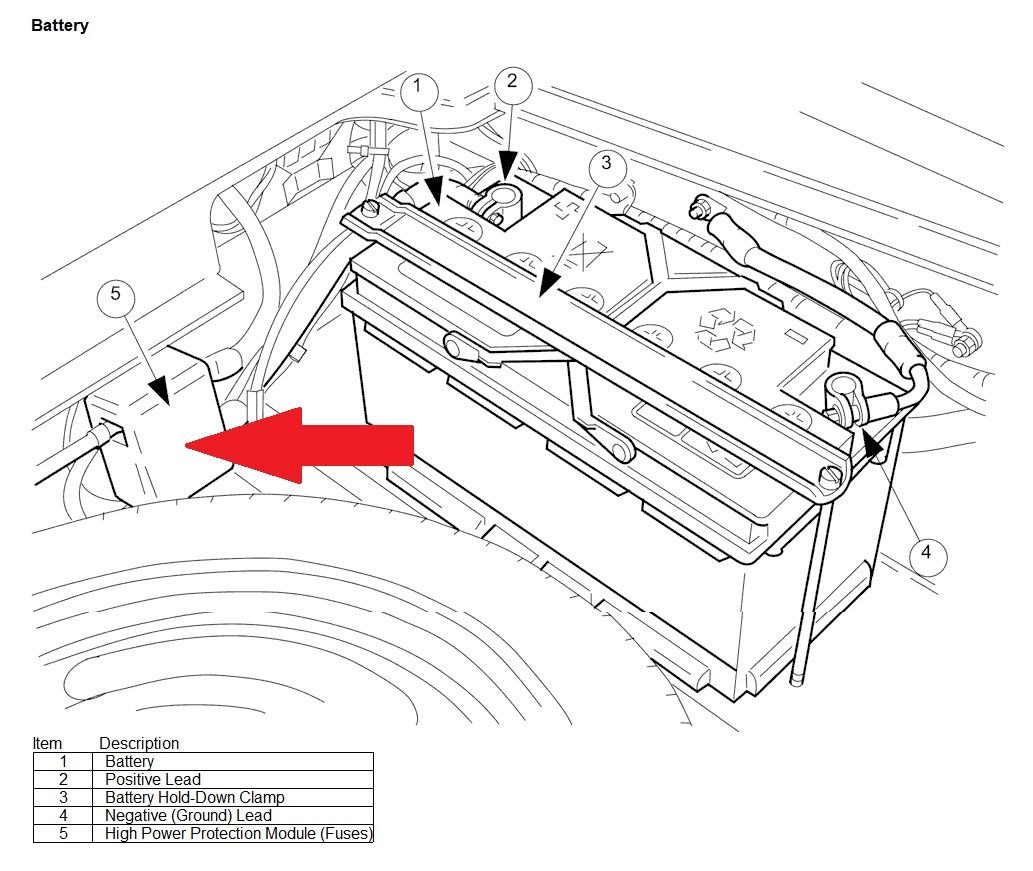

Eliminate the obvious first. A poor/loose connection in the HPPM (High Power Protection Module):
Lights etc continue to work but insufficient power to crank.

I have gone through the module, battery, grounds that I can find, connection by ecu in engine compartment and alternator conection on the fender. Got a half turn out of several connections and the battery terminals were not the cleanest. Will wait till it happens again. Problem is I am usually alone and its hard to crank and test by yourself even if you brought a meter. Thanks for the input, I will pull the schematics and see what controls the interlock on the transmission. Maybe that will lead me somewhere.
