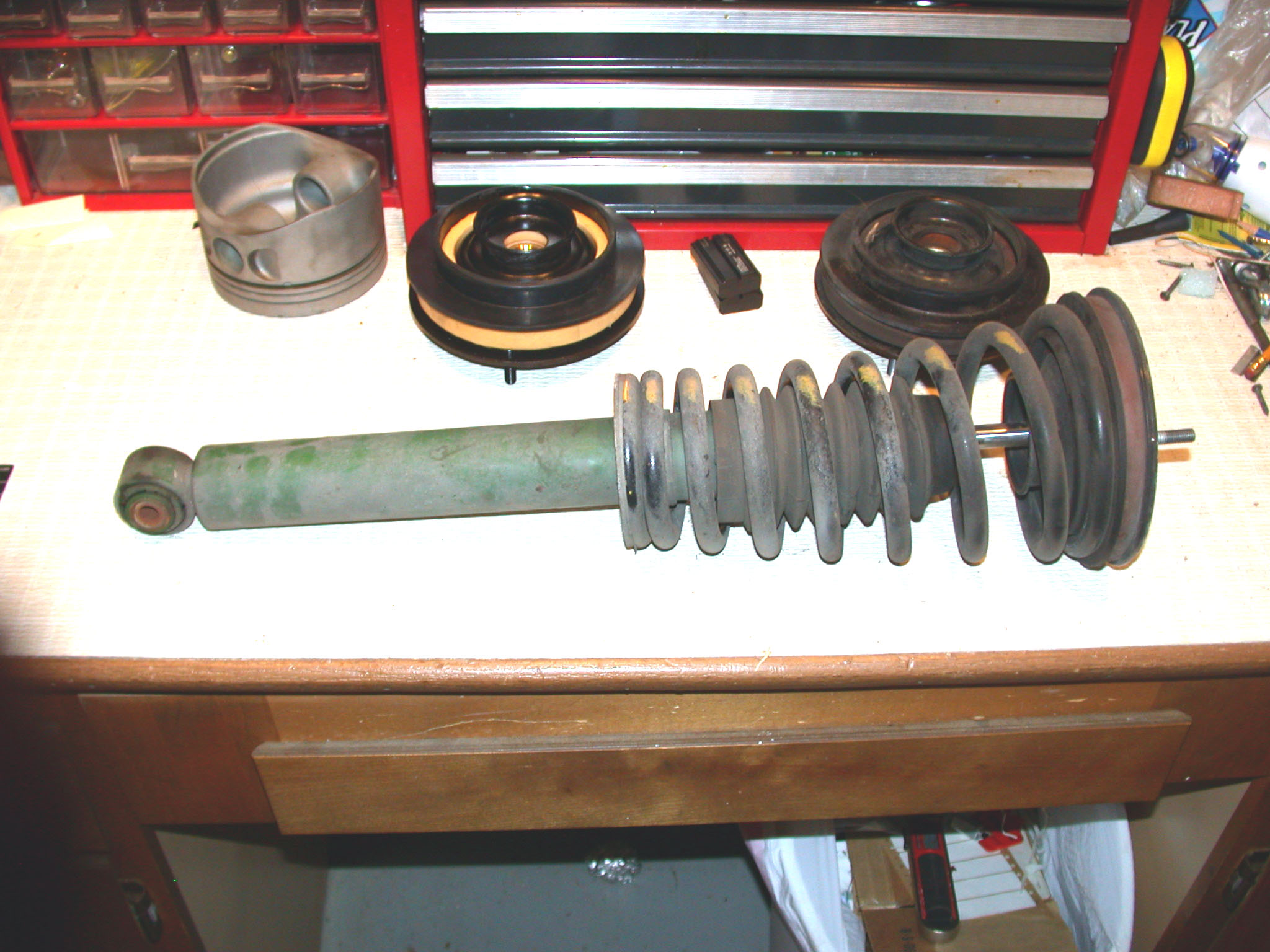

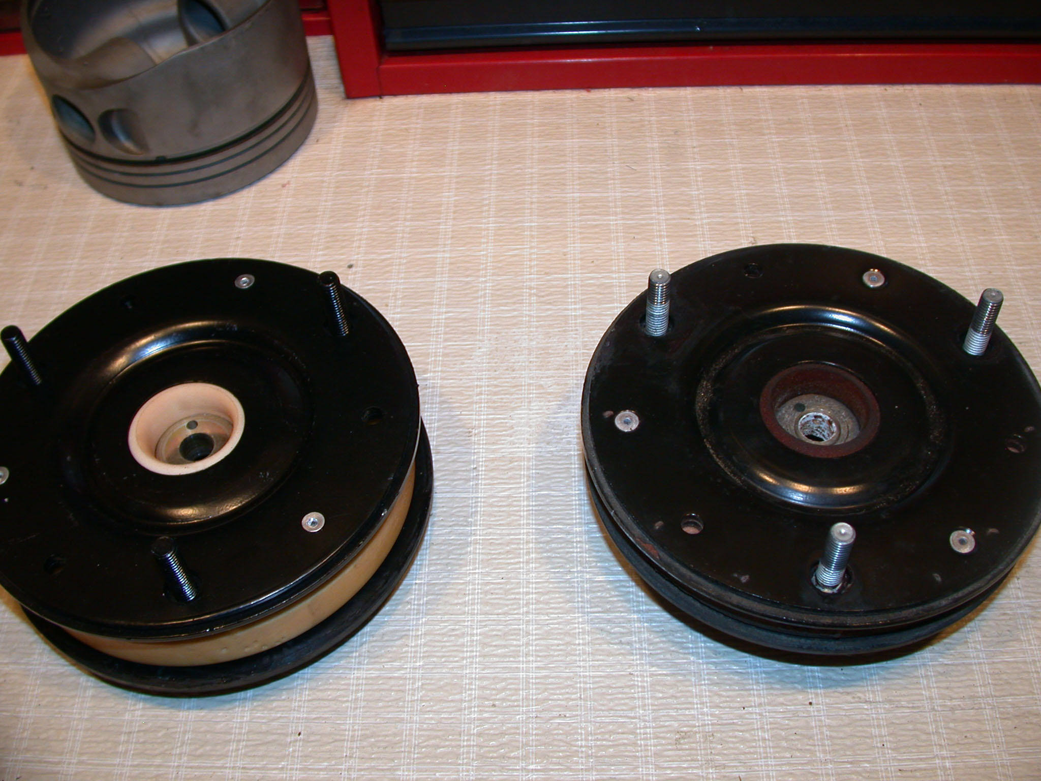

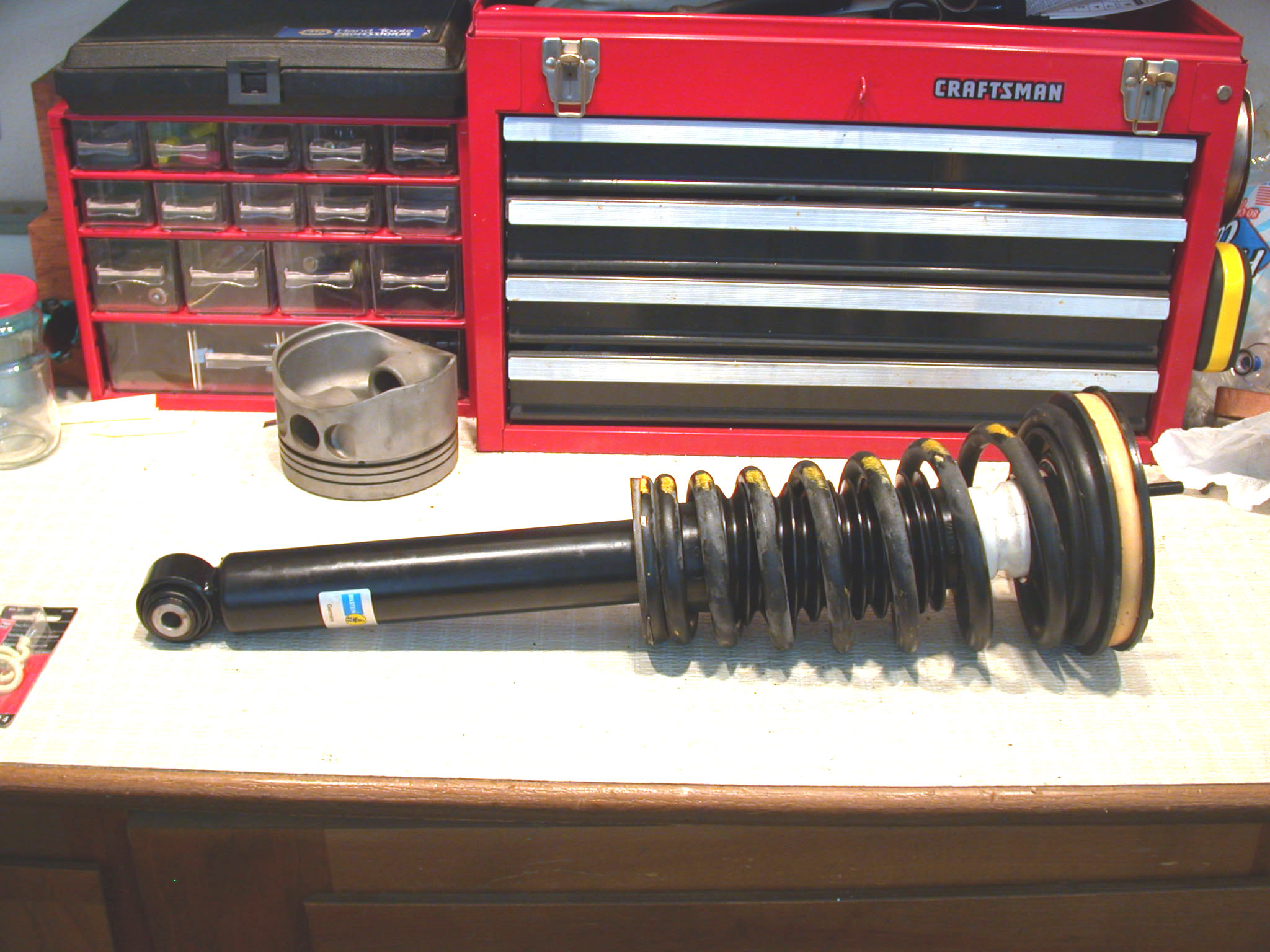

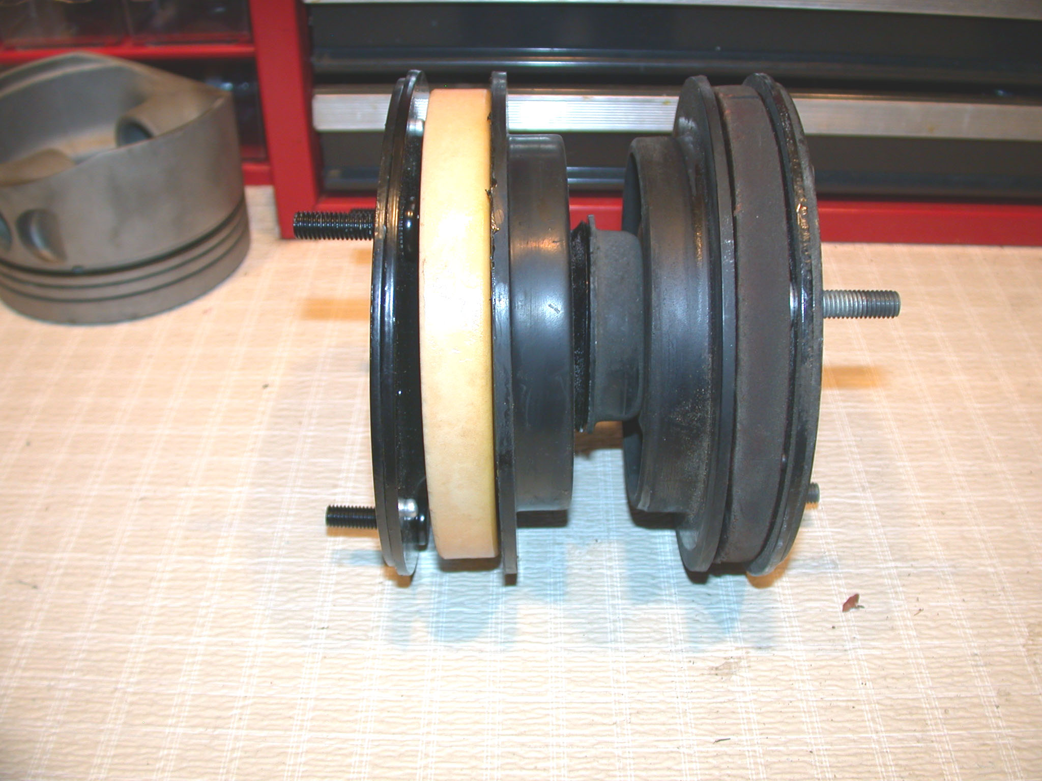

Smile 2000 XK8 front stru overhaul
I thought you might like to hear about the overhaul of my front struts. Right after I bought the car I had it on a lift and noticed it had deteration of the lower bushing in both front struts. There was evidence of oil that seemed to be the cause. Where it came from I have no idea. Everything else was dry. At that time the car had about 42K miles. And driving it there was a klunking in that area that I really didn't like. I toyed with the idea of just replacing the bushings in place. But the darn bushings cost more than the shock with the bushing installed. So I bought new shocks. Checked around as to where I could do the work as this wasn't something I really wanted to do. Time went by and klunking got worse and a friend said "We can do it". Parts got ordered and forum got read. Everyone said if you replace the shocks got to replace the mounts also. Looked at mounts and they looked like they might be starting to deterate. New shockmounts ordered. Everyone said got to replace rubber boots also. Boots got ordered. Car by this time had 52K miles. This wasn't something I was looking forward to doing. Rented spring compressor from parts store. Took my friend and I two evenings to do the job. Other things going on. Also following Rev Sam video. Left strut wasn't bad getting out. But the right one was a reall b...h. I must have taken me an hour to get the upper A frame bolt out. And after I got it out I found out why. One of the trapped washers was a press fit on the bold. somebody got wrong parts initially. Rev Sam also had trouble with the right side and I bet for the same reason.
Now on with the spring compressor. Luckly my friend had an air wrench or we never would have made it. You must have one to operate the spring compressor and two people are a must. Assembly was straight forward and remounting on the car was OK.
The car rides much better with out the klunking and I am done with that job. I now have done this job twice. My first time and my last time.
When I got the struts out I noticed that the mounts were still in really good shape and could have stayed with the old ones. And the rubber boots that everyone said I just had to replace were OK as well. But now I have new shocks, mounts and boots with a good upper seal plug.
The following pictures show new and old parts. Enjoy.
