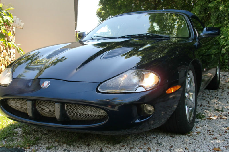

In this picture:
There appears to be some paint shade variation from the bonnet to the bumper cover as well as a mismatch in contours and gaps. Is this consistent with age, or is it a sign of damage and repaint?

The apparent paint mismatch on the front end vs. the hood may not be a problem. Somehow there seems to be an issue with light reflection when taking pictures of these cars. Mine looked that way in its ad, but was fine in person and has no signs of body work or paint respray when viewed in person. Some colors look worse than others.
I passed on a coupe because of this issue, but had a chance to see it after I bought mine and it was fine. (the interior however was not so fine, so I would have passed anyway.)
The gap lines however might be worth a better look.
The hood is made of steel. The bumper cover is made of rubber. Only at certain angles will the paint look matching. From that angle any XKR will look discolored.
+1
In addition, for the paint on the front of a 2000 to look that good, it must either have been refinished or gone no real distance.
I'm lucky to get two years before the stone chips on the bumper make a repaint necessary.

The left headlight appears to have condensation.
