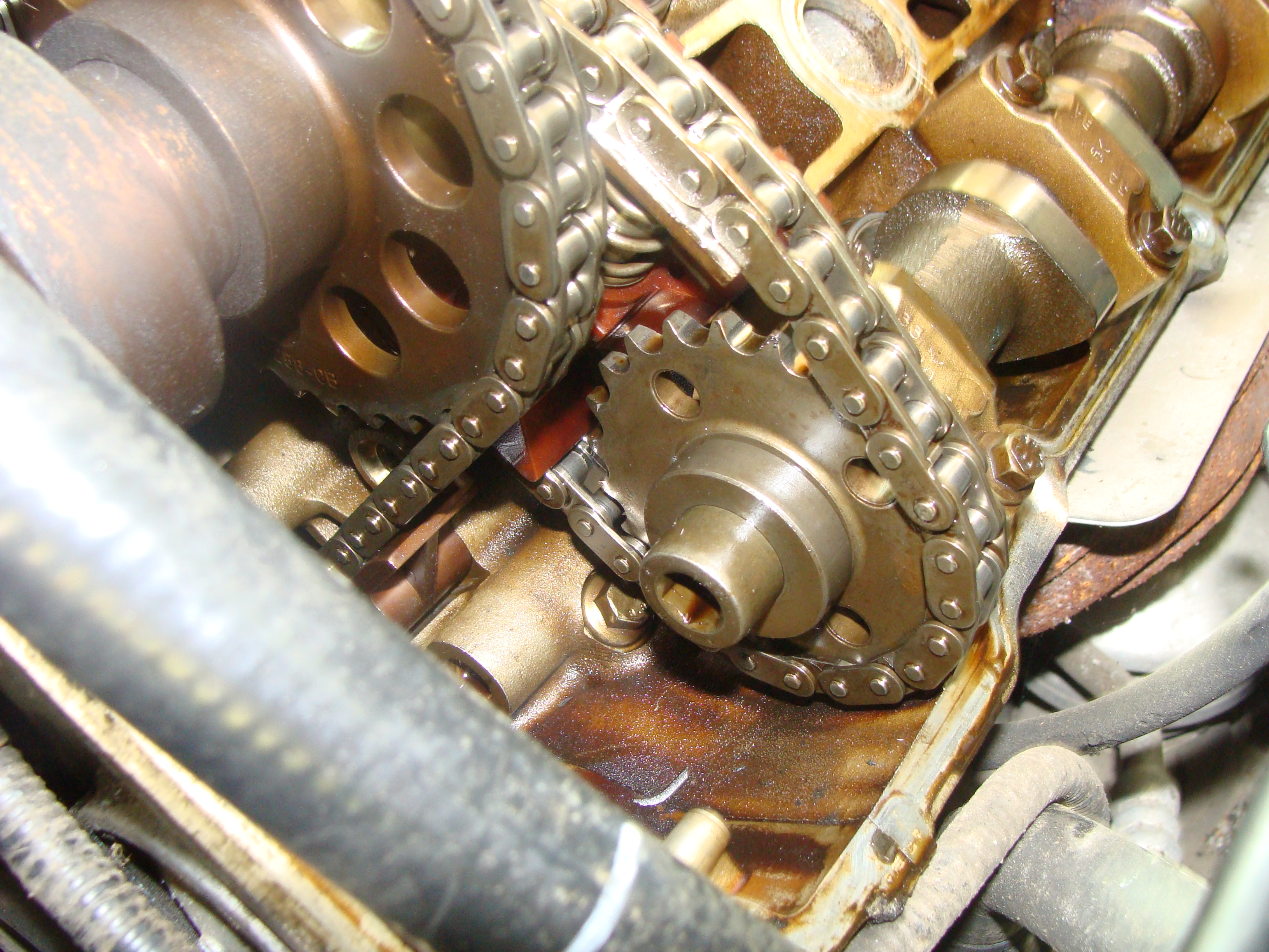

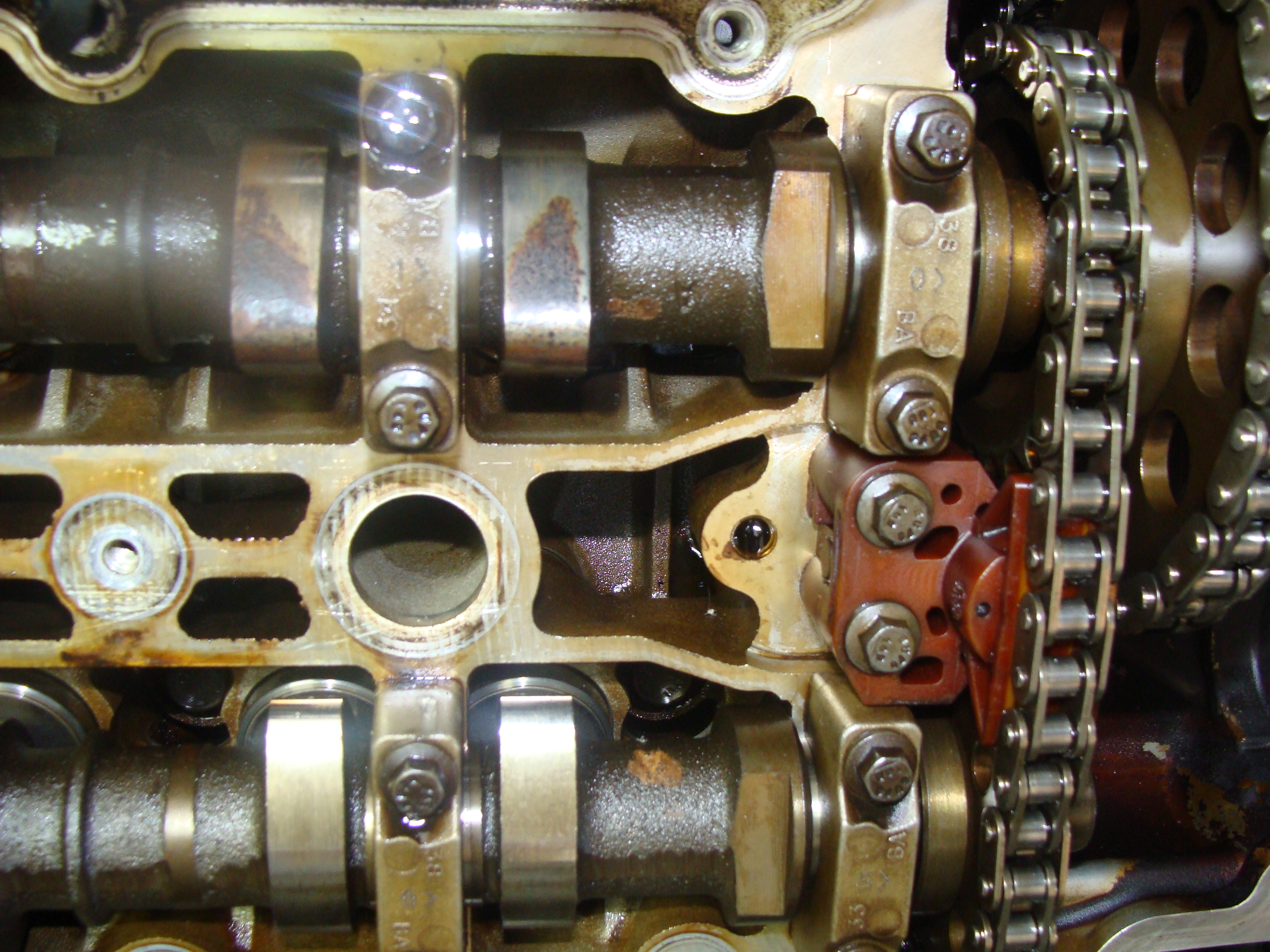

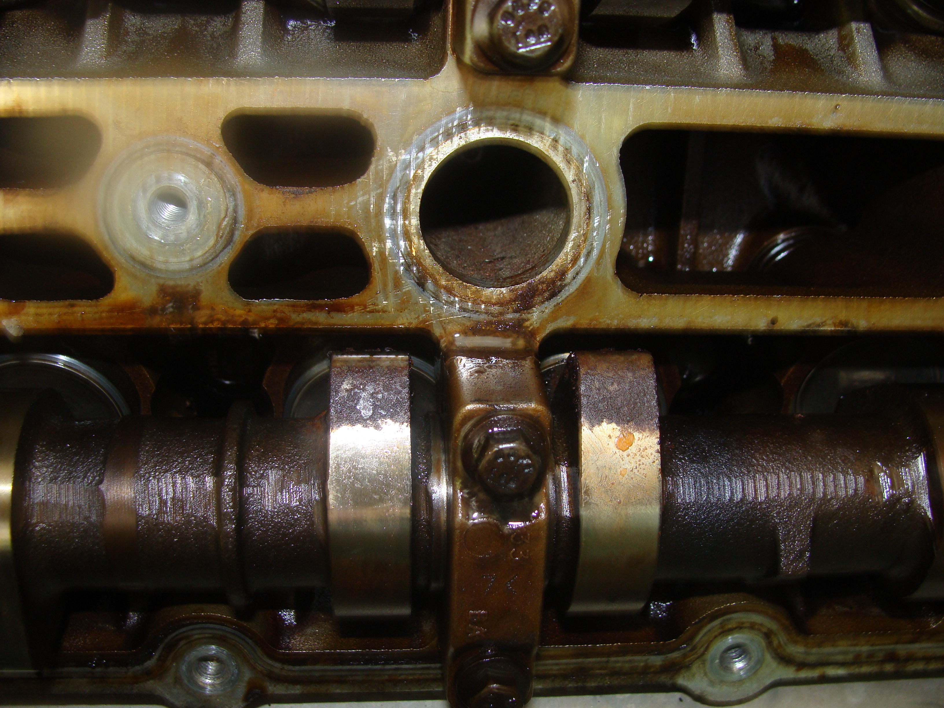

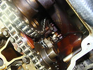

Not sure what you mean, I can make any cam shaft flats line up if I turn them in position. Also removed drivers side valve cover no damage to upper tensor, I can depress the tensioner by hand, don't know if that means anything. Also some of the cam lobes have rust/corrosion on them looks like the car was sitting a long time or water? Coolant was low too, I can get some slack in the primary chain if I rotate it right. Looks like I need to dig deeper.

Some Pictures for what it's worth...

I would buy new ally body secondary tensioners before doing anything else, fit them --use the zip tie method and then investigate the no crank, at worst it will be $60/ 100 bucks wasted and some time.
At best it will be a good engine saved and possibly a starter motor/battery/ring gear problem.

joesoap is correct about what you have!!
Yep, those are some GEN II plastic body tensioners. I would get them replaced ASAP.
Might be a faulty starter motor?? for the no-start problem.
Move the engine a few revolutions to be sure about no other obstructions.
