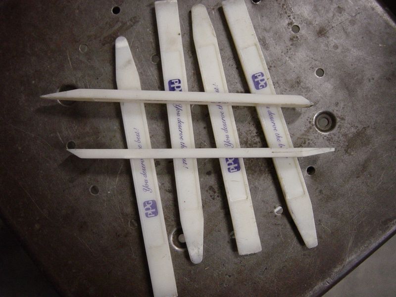

We like to know what we should use to gentle pry and loosen the trim panels from their spring clips on the instrument cluster and center section of the dashboard.

Go to a windscreen/windshield shop and get some plastic pry sticks. They are like THICK popsicle sticks and have rounded tapered and wedge ends (opposite). I use these ALL THE TIME.

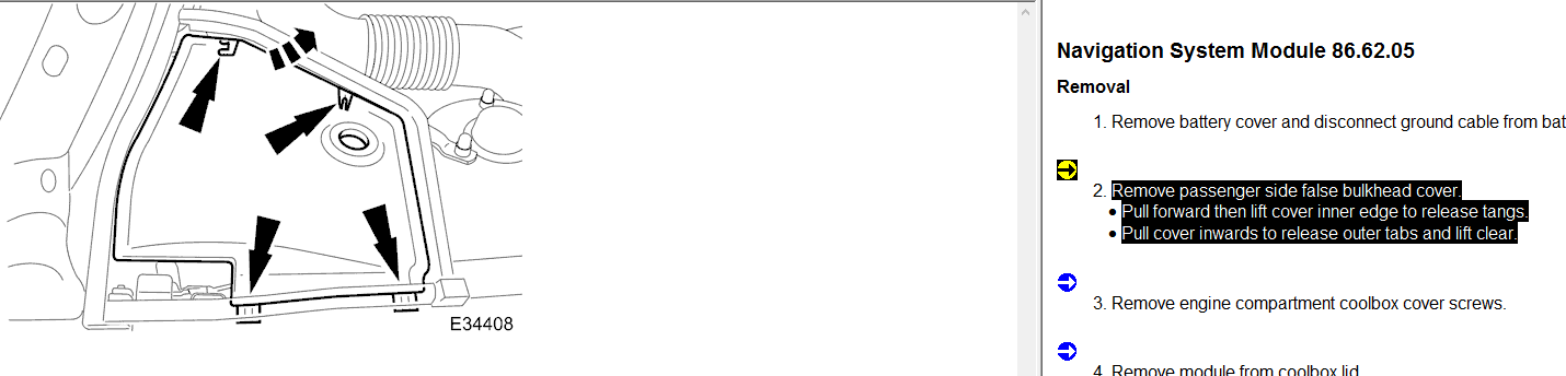

I have been chasing a rattle that appears to be coming from the center of my dashboard at the top. I feel that if I could remove the top of my dash board I would find a 14mm bolt that has lost the nut and is rattling against a piece of metal. I have tried everything in 910-05, 910-10, 910-11. The one I am having difficulty with is locating the False Bulkhead Mounting Bolts described and pictured in 910-04. I wish there was just a bit larger picture so that I could gain a better reference. Can someone help me as to where these bolts are located on the XK8?
Here's something from JTIS, the FalseBulkheads are inside the engine compartment, with the covers on each corner.. I'd say somewhere in there
