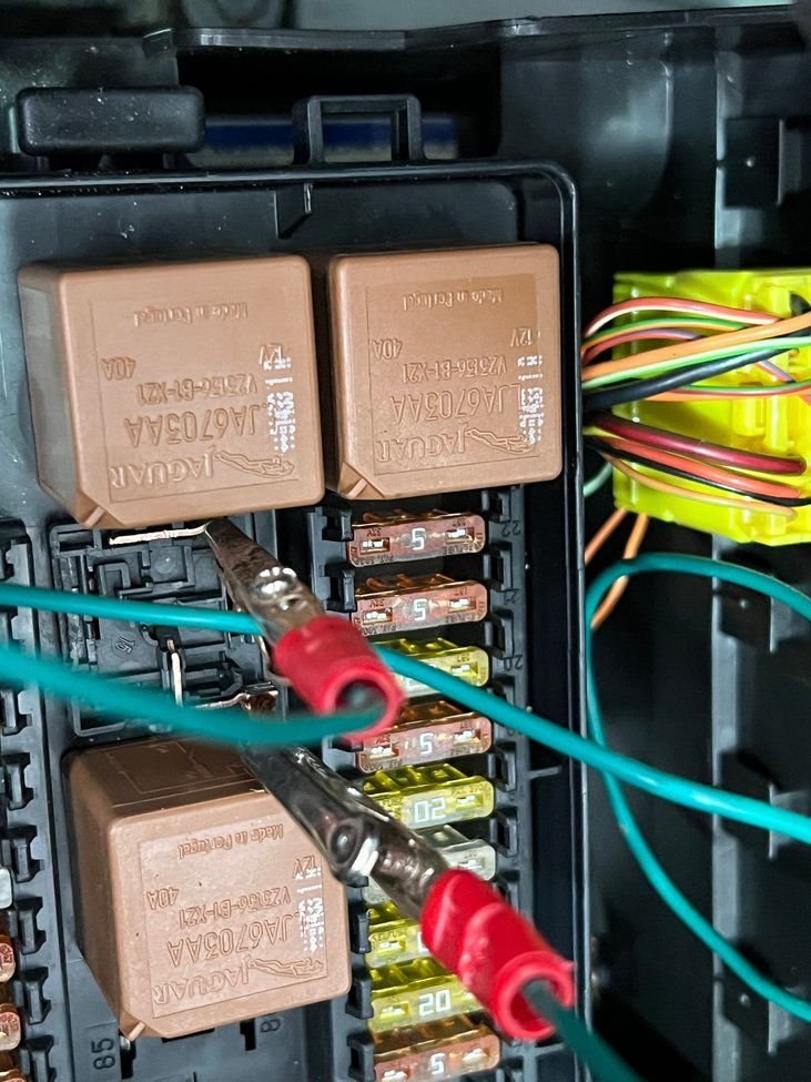

You can disconnect the fuel rail supply hose in the engine compartment and get a hose to a large container.
Then jump the relay socket (30/87 or 3 and 5) terminals with a short length of wire to run the fuel pump without the engine running.
The relay is in the boot fuse/relay box behind the battery.
The relay position is..X
OOO
..X
..O
..O
..O
bob gauff

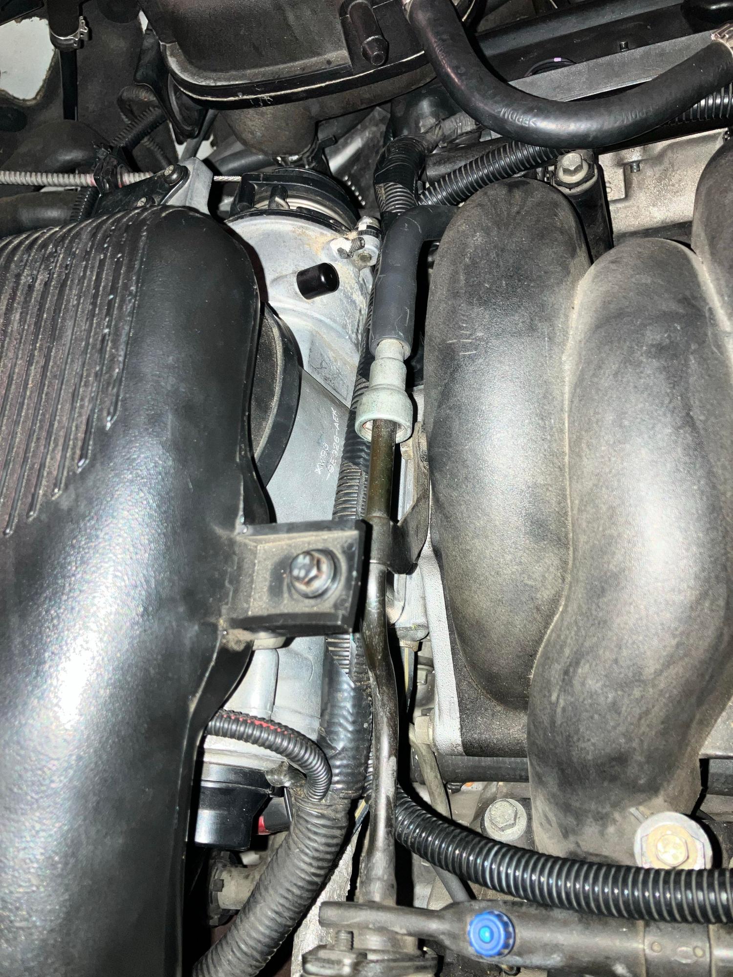

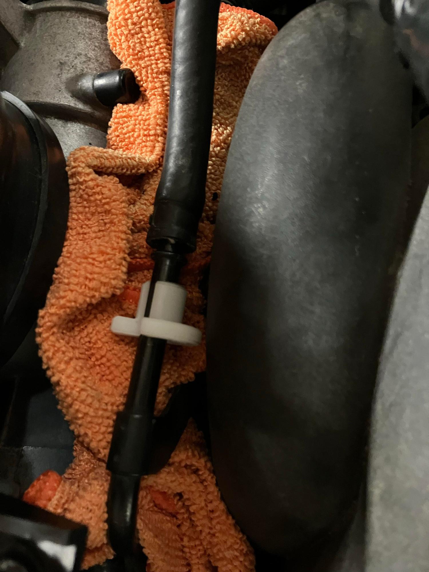

I believe the fuel rail supply is under the fuel rail shown here. I think this is the return line and I can disconnect it and connect a rubber hose to the brown tubing to drain the tank using the fuel pump. And no need to plug the female receiver on the fuel return line.
Is that correct?
OOO
..X
..O
..O
..O
bob gauff
Getting wire in plugs difficult so i broke open an extra relay.

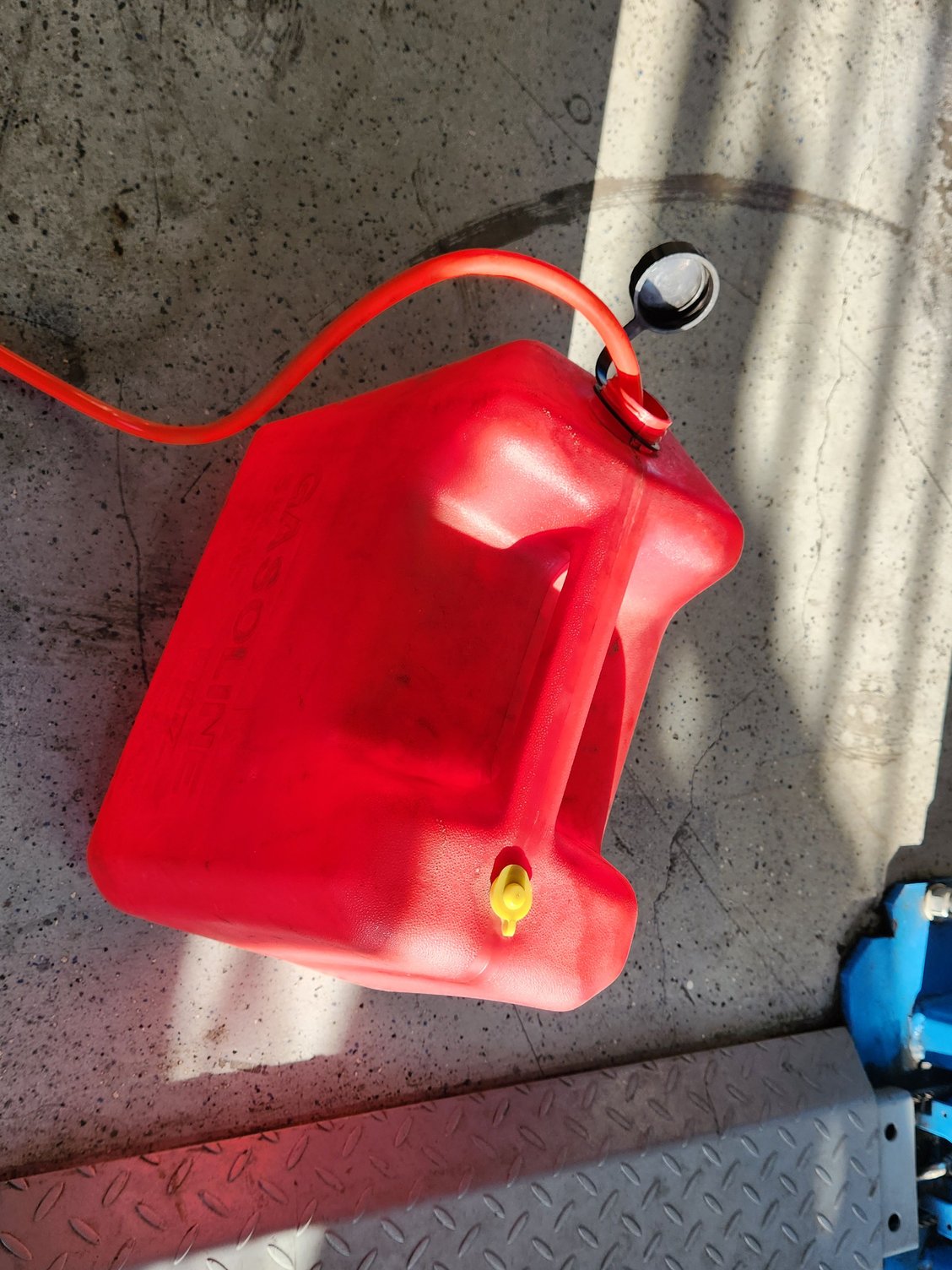

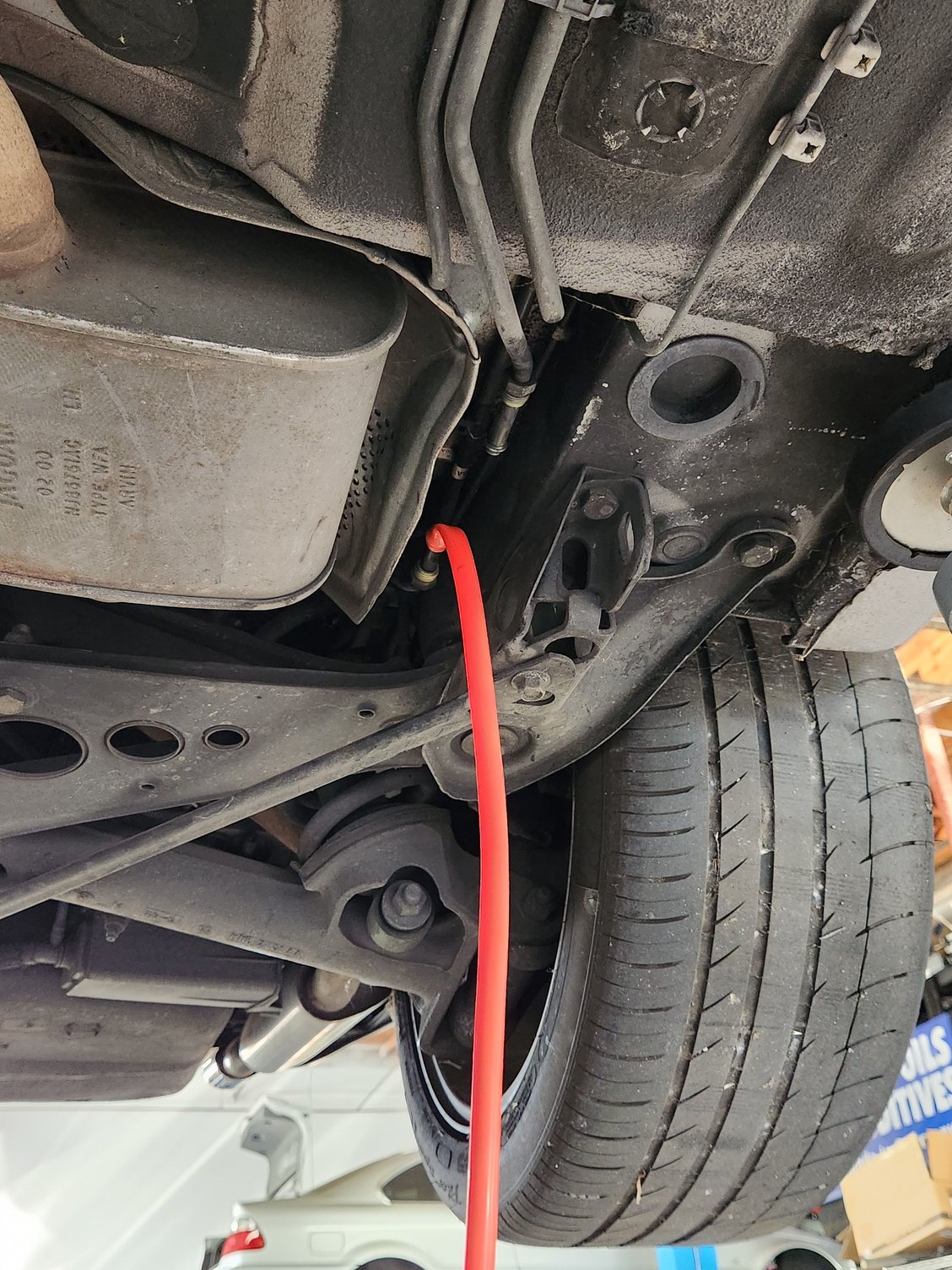

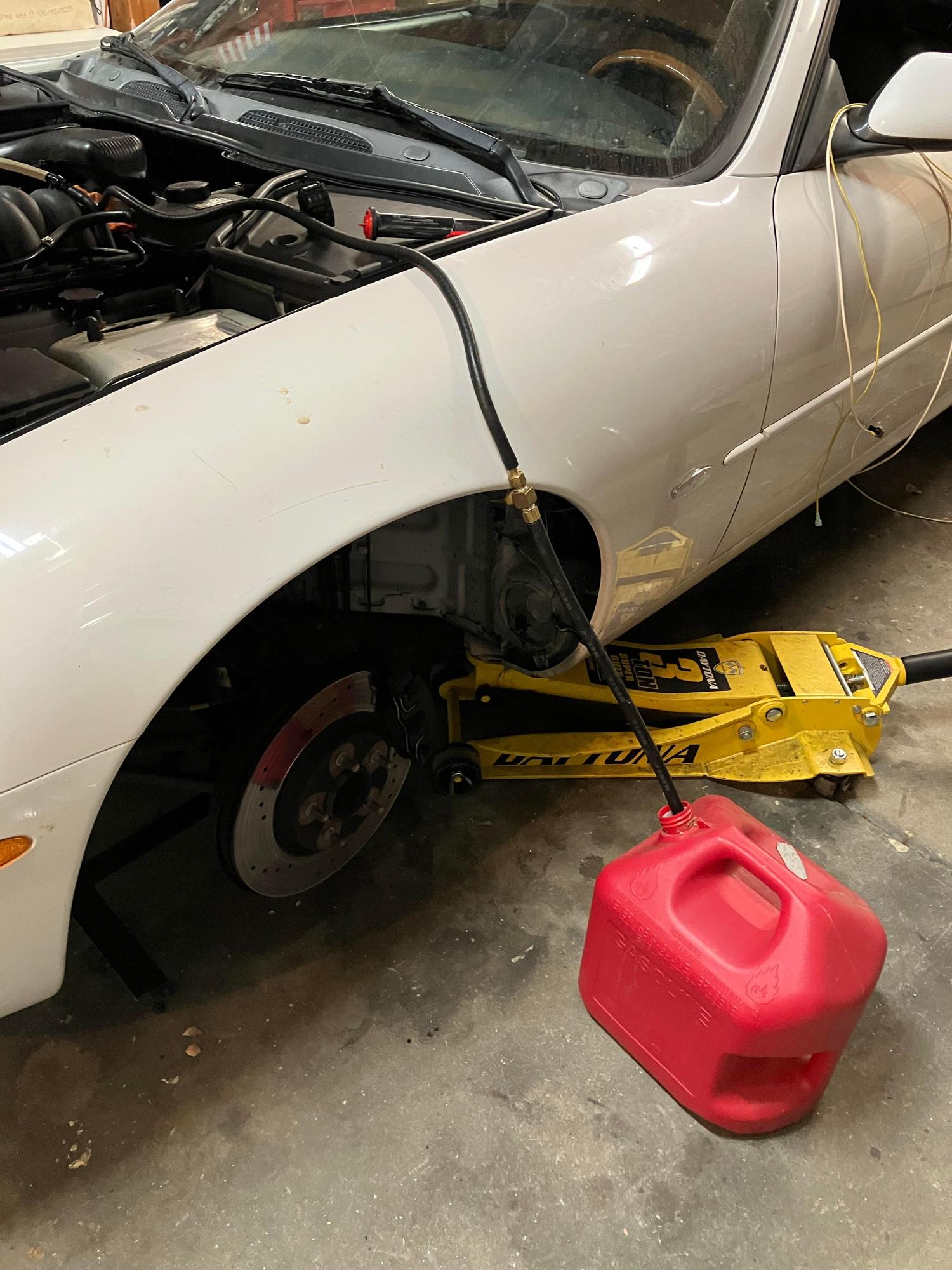

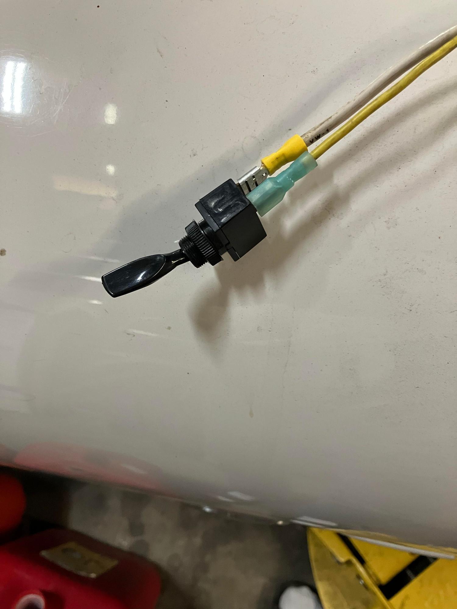

I pulled the return line from connect and attached a rubber hose then used a switch connected to relay contacts. Just over 9 minutes for 5 gallons​​​​​​​
