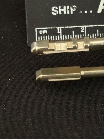

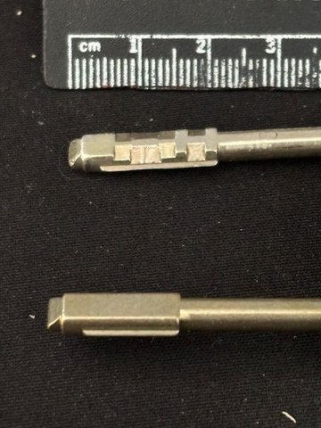

Well the new flip open keys came today. They're supposed to be for the 2000-2006 XK8 but the part that gets the notches cut into it looks to be too short. I'm going to take it to the locksmith who said he can cut them and see what he says on Monday.

The blank key is for the later 4 bevel, 6 cut keys.

Search for an 8 cut key.
