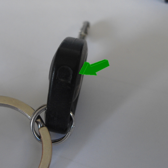

You already have the cut stem keys, which is the hard part. You would need to procure the fobs (pretty cheap on eBay, say $20 ea), and a couple of Megamos 48 (also cheap if you can find them). Then spend an hour in the garage putting it all together. Last, you would have to have them programmed in to the car, but you are looking at doing this anyway at this point.
As already pointed out, I am sure you can retail this out, and have a mobile locksmith come to you with key blanks, cut them and program them in one sitting. Expect to pay for the convenience, though, I have heard as low as $125 per key. Could be fees, too.
Last "hack" option is to take a hard look at the black plastic key handle you already have. There should be some form of a plug to keep the transponder in place. Or not if you have no transponder. You could always buy a couple of Megamos 48, drill the plastic handle, stuff the transponder in there and seal it off. Then on to the programming.
