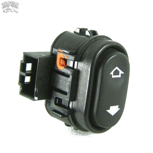

On closer inspection, there looks like there are different types of switches that are very similar looking. Some seem to have a thin black frame around the actual button. The one that I got (and doesn't fit the XK) does not have this. See the attached picture of a button from a 1998 XJ. The one I got is close, but different, maybe it's from an S-type?
Also it appears that the 1998 - 2002-ish Mercury Cougar Mystique and Ford Contour has the same style buttons...
