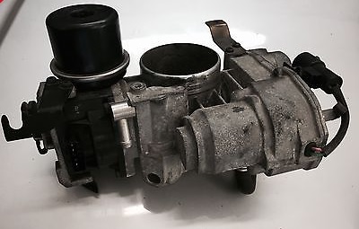

Here's the old and new TB on my 2001 XK8:
This is what I'd describe as the 'later' type for 2000 onwards. The 'early' type for 1996-99 models looks like this:
You should have the 'later' type but don't guess - check!

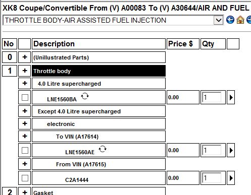

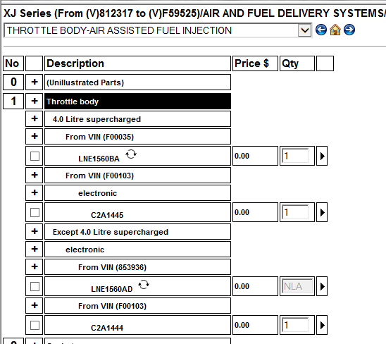

Here are some extracts from JEPC, both for XK8 and XJ. As you see there is a change in part number for the XK8 at VIN A17614, but not for the XKR.
Attached Thumbnails 2001 xkr TB confusion-xk8-tb.png   2001 xkr TB confusion-x308-tb.png

Ill have to wait till I get my car back. I don't recall the little air assist for injectors (never ever heard of that before) but I suppose rather same than sorry. Then of course still looking forward to my Autorotor swap on my xjr....That should be fun:O)

Its really a shame we are stuck with this itty bitty TB. I checked and I do have the non air assisted one. I've been playing with supercharged factory cars since the Thunderbird SC with the itty bitty m90 Eaton. And even that tiny v6 with that tiny SC is restricted even in stock for with less than an 85mm TB 3.5" air intake and 90mm or so TB...It just kills me knowing that no matter what I can reasonably do....My Jag will always be restricted.!! Anyways..Again thanks. Now to send my TB's to Maxbore
