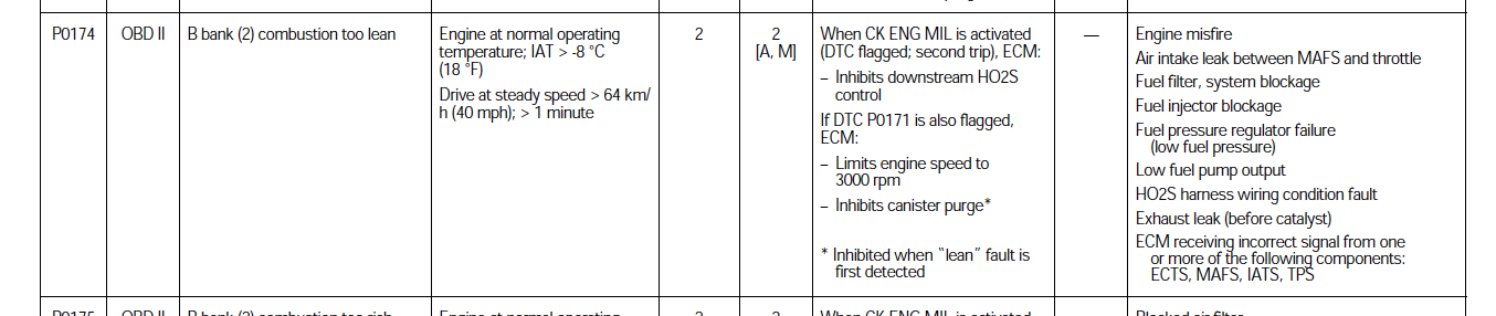

Possibilities below. Obviously, some of these things will likely cause lean codes in both banks. If you really think you damaged the electronics, you can swap connectors, as mentioned by RJ, but you also could go down the more capacious rabbit hole of doing the pinpoint tests from the Workshop Manual on the ECT, MAF, IAT and TP sensors.
A little story. I recently put off the easy smoke test because I had already replaced everything that I was previous leaking and I thought would leak in favor of the electronics pinpoint tests in the Workshop manual (must be the electronics, I reasoned, for my both bank lean codes, and wife hates the burning mineral oil smell). This wasted much time when the apparent failure I found doesn't apparently cause lean codes (confirmed on one of the other cars). So, the workshop manual is not particularly helpful there...
When i smoked it, i found the leak i in a few minutes that I had apparently induced by disturbing the dipstick tube when i replaced the cam cover. I would have saved a lot of time smoking it first (and telling my wife there must be a refinery fire somewhere nearby), especially with no other codes.
Possibilities
