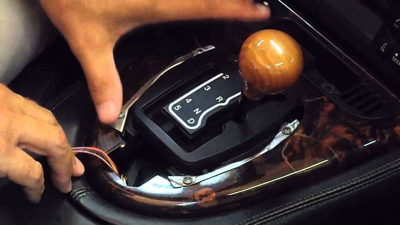

Likes: 6,652
They could be confused with the numbering on the J gate.
Does it look like this with numbers up to 5?
If so it is a six speed box.
Good point. To a non-Jag nerd, the 6-speed selector does appear to indicate there are only 5 speeds.

@Norri - many thanks to you too - especially as your post seems to have cleared up my question. The AA engineer would have looked at the J-Gate layout and assumed 5-speed.
