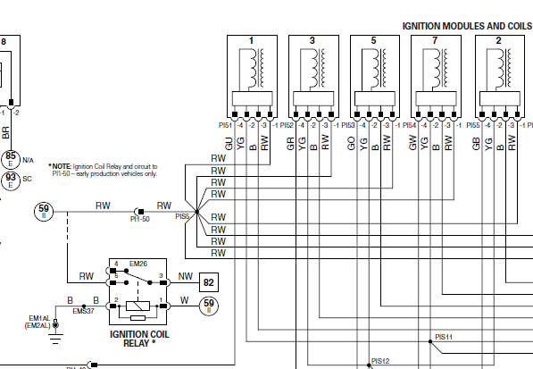

Originally Posted by Pantera928
There is no spark when this happens.
So you have established that. OK - next question is why no spark?
For starters, can you wire a tell-tale lamp here semi-permanently between any R/W wire and ground? That at least will tell you if you have B+ to the coil packs when the fault occurs:

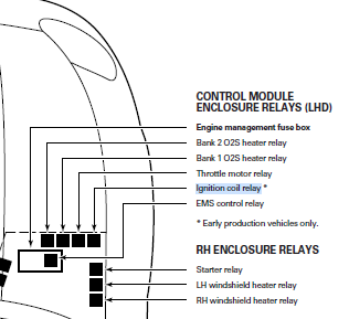

You may or may not have an ignition coil relay. If you do, it's here:

From: Northampton, UK
Crank position sensor or its wiring ?
Pull the relay in the diagram and re insert with a thin wire in turn to 1,3,5 with a small bulb to earth and see if you loose supply.
If yours has the two igniton boxes I assume you have checked those.
