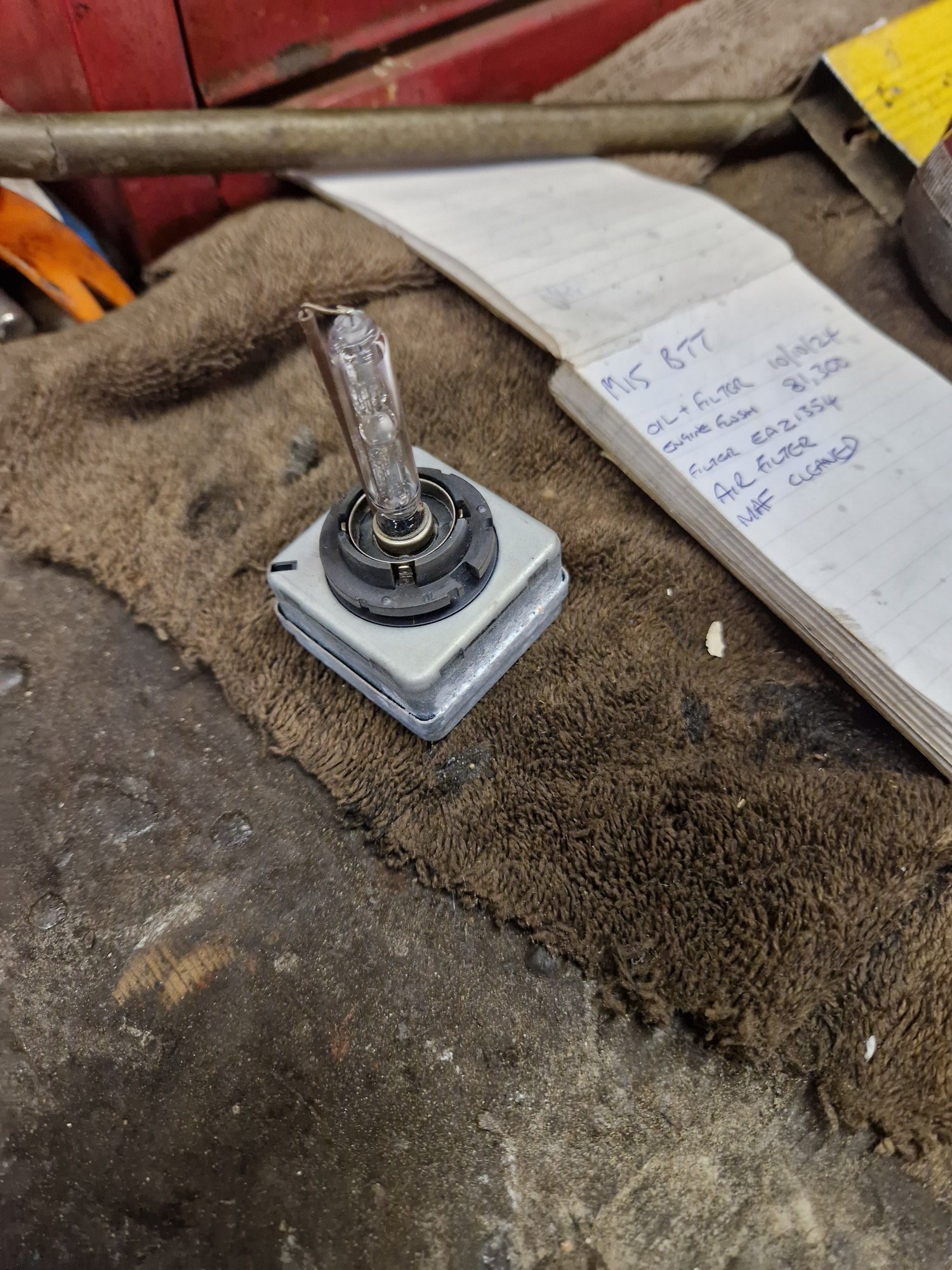

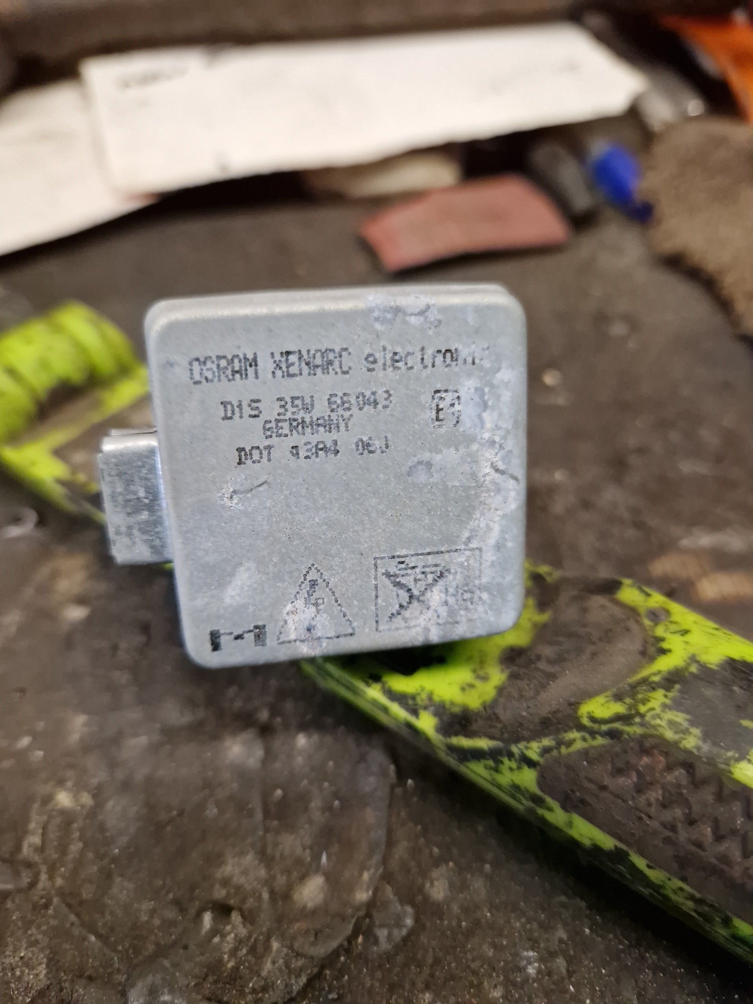

Good afternoon all, as i continue to prepare my xkr for its mot i need to replace a low beam headlight bulb. I knew they were not the usual halogen bulbs but this is the first time ive come across hid. I was a bit surprised and unsure about what id got im hand after removing it, and even more so when i saw the price of replacements lol. Ive done a bit of research on youtube and some advise changing both at the same time. I just wondered what the forum thought and if they have any bulb recommendations with economy in mind. Many thanks for all input.

From memory, you need a D1S "bulb". Tons of cheap options, check eBay or Amazon. Buy a pair and replace both as they dim over time. Only option is the color/temperature where you can go from more yellow to white with a hint of blue. Our cars are old, so keeping it more yellow makes sense to me, but your car your choice.
This is just the bulb. There is also an associated "ballast"/power supply. This can be a lot more pricey depending on options. I'd say start by swapping the bulbs left to right to determine the cause of the issue.
If you need a ballast, the issue is that our earlier '03 cars need a model that controls the tilt based on the input of the level sensor on the control arm. Those models are expensive/branded. The 2005-6 did away with the level sensor I believe and the ballast for those is super cheap. You can use the later ballast in the older car, (direct swap, same connector) but be prepared for the headlight to be angled down more than you might like. Might be good enough for MOT as it would not be blinding to anyone but less than ideal if you do a lot of night time driving on the countryside.

Hi and thanks for the assistance. Car will be a summer car and I don't think I will be doing a lot of night driving. Some useful info there. I will swap sides with the bulbs and report back. Fingers crossed.
