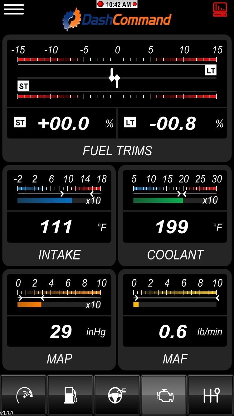

I got my F's and P's mixed up. I cleaned the MAF but despite the cleaning my MAF is still at .7 lb/min. The MAP is 9.9 Hg at idle. But after using Techron treatment it does seem to be running better. However, at idle or slow speed the RP light will come on - no problem with RP at speed.

I am running on my second tank of Techron and things seem to be improving but still getting a sporadic RP light but it has not thrown up the knock sensor code lately - one knock sensor code stored but with exception of P1000 code no other codes pending.
this is a screenshot of OBDII reader. Do these number look good or do any of you spot any problems?
thanks,
Bill
This is at idle.

On that shot your MAP sensor is not working/being read correctly as it is showing atmospheric pressure

Wight8 thanks for the reply however I am confused. According to the XK8 Bible the MAP reading should be 10 inHg. If I am reading it correctly, my screen shot reads 29 inHg. Am I misunderstanding the XK8 Bible?
I am definitely a rookie at the OBD11 coding.
Thanks,
Bill

The Manifold Absolute Pressure is just that, it measures the Absolute pressure, in other words without the engine running - or if you took it out, it would read 29.9 inHg - which is the Absolute pressure at sea level, or for us over the pond 1 Bar or 1 atmosphere. With the engine running you have vacuum in the manifold so you have LESS pressure - I have not checked but 10 inhg sounds about right. Your engine thinks you are at full throttle so it will be rich and have the ignition retarded.
Take a look here for an in depth explanation https://www.aa1car.com/library/map_sensors.htm
Looking at the manual, if the MAP sensor is broken it substitutes the 29.9 value but it should also set P105/6/7/8
