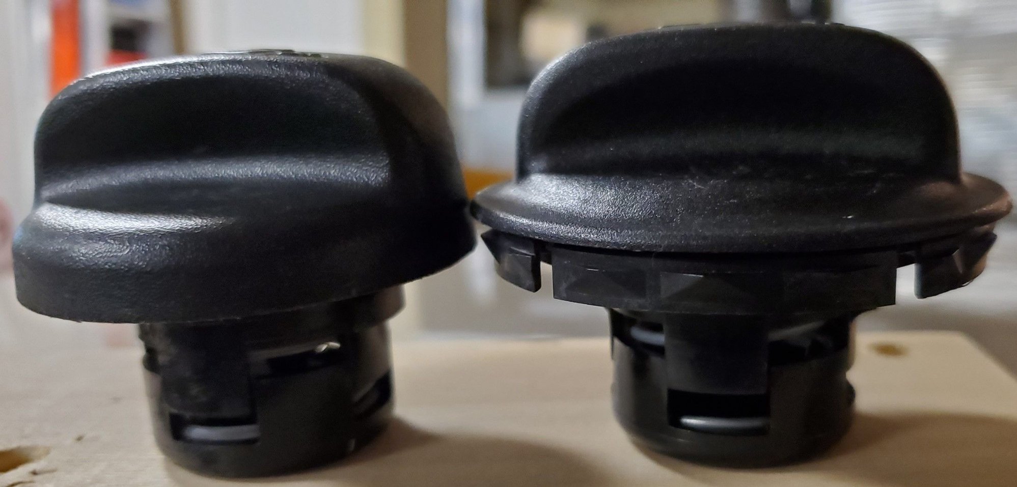

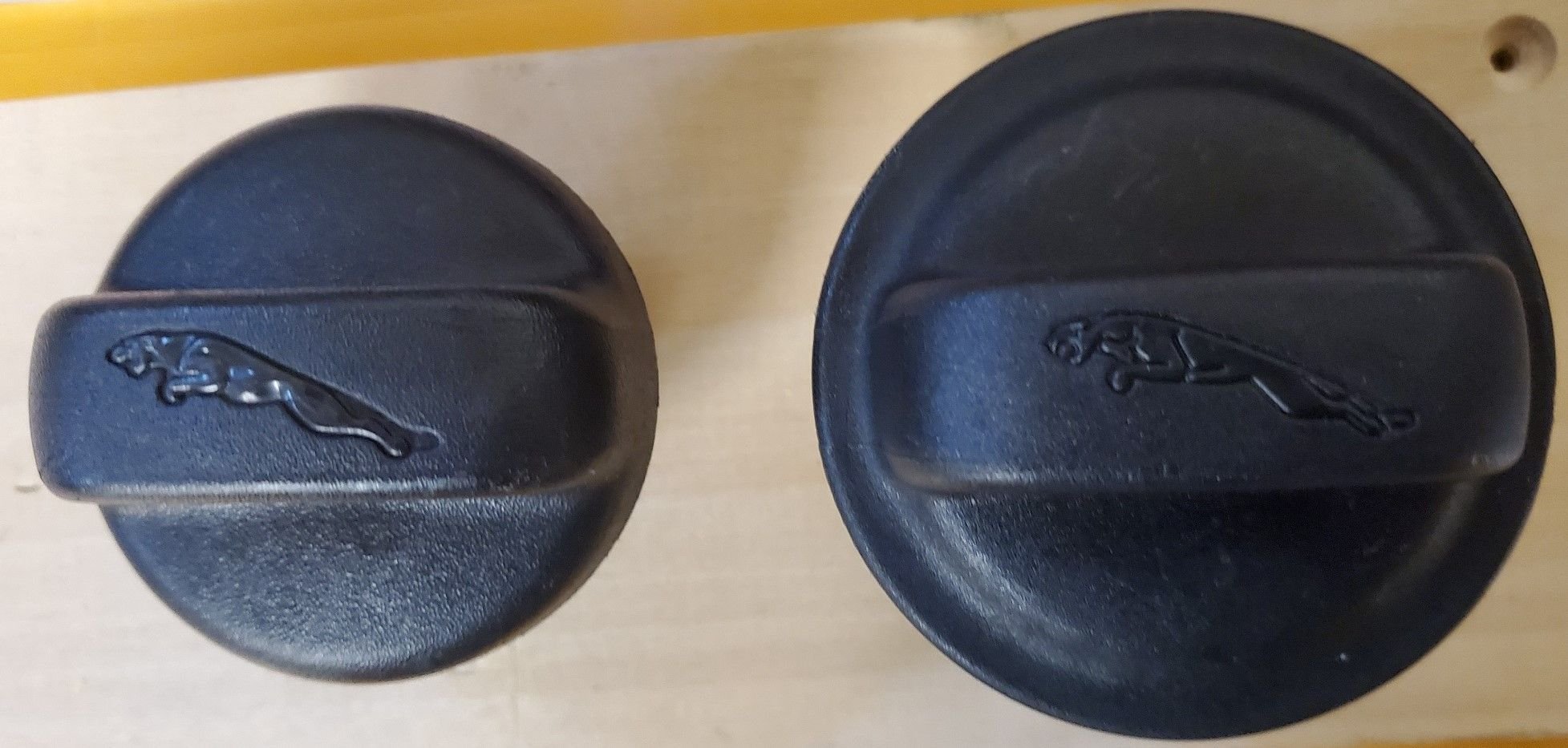

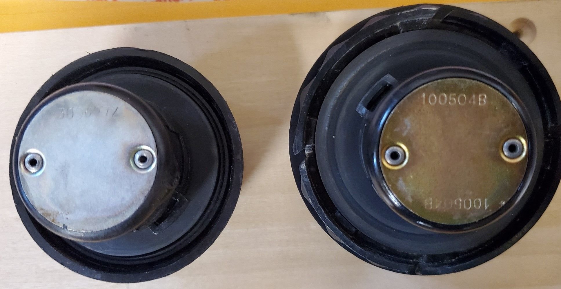

Here are some pix of the original & updated cap. Again, this is for a '98 so YMMV.
The old cap is on the left and has a smaller top. The old number seems to be 300697Z.
The 'new' 20 year old cap is on the right and has a larger top. The new number is 100504B.
The side view shows larger vent openings on the new one.

My current cap is the one of the right, the newer cap. However the number on my cap is 100603F

I figured your '04 would have the newer cap but hopefully yours has just gone bad. I'm no mechanic but I can't think of any other reason there'd be a downstream problem just because the tank is full. have you tried filling the tank to half or 3/4 full to see if that makes a difference? BTW, when I removed the cap to take the photo there was a whoosh sound which I think is normal.
