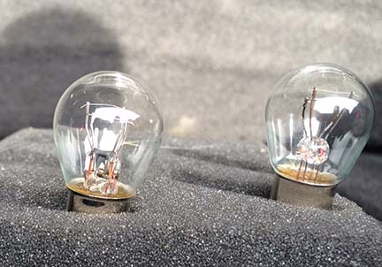

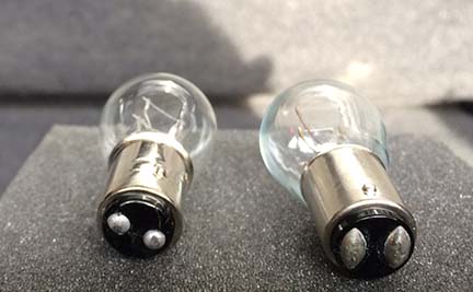

Thought I'd share a fix that finally got rid of the 'Check REAR LIGHTS' message every time I hit the brake pedal.
I had a brake/tail light on the rear passenger side fail. I went to Advanced Auto and they provided a bulb that worked when braking. However, every time I hit the brakes the 'CHECK REAR LIGHTS' message would display.

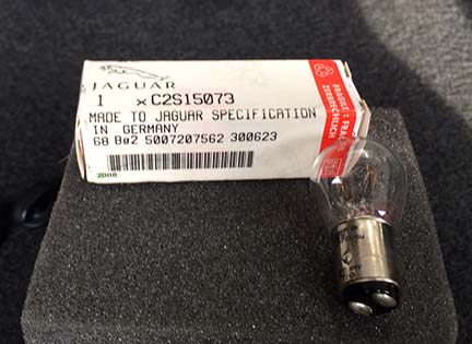

Checked all lights, read a bunch of posts and eventually called a local dealership in Naperville, IL. They weren't sure, but suggested I try the bulb they had as it was slightly different than the one I installed.
I installed the new bulb earlier today and so far, the message no longer is displaying.
A couple of things to note; The contacts on the bottom were slight different in shape (Adv Auto on left, Dealership on right) and there was some type of grayish material in the bulb at the base of the inside. I added the image of the box from the dealership in case that helps.
Just happy the message is gone!

Probably a different (out of range) current draw on the aftermarket bulb. The car measures the current flow to determine if the bulb is connected and good.

Too bad no one has developed a no fault, two 'element', all in one LED replacement bulb.
By the way, two element brake light bulbs are overpriced if the box says Jaguar. Oops, forgot, it's a Jag.
Anyway, I bought a pair of the Jag bulbs due to a burned out brake filament in one of my brake lamp bulbs. For good measure I replaced both sides at the same time. I haven't seen my fault indicator light go on for a real long time.
