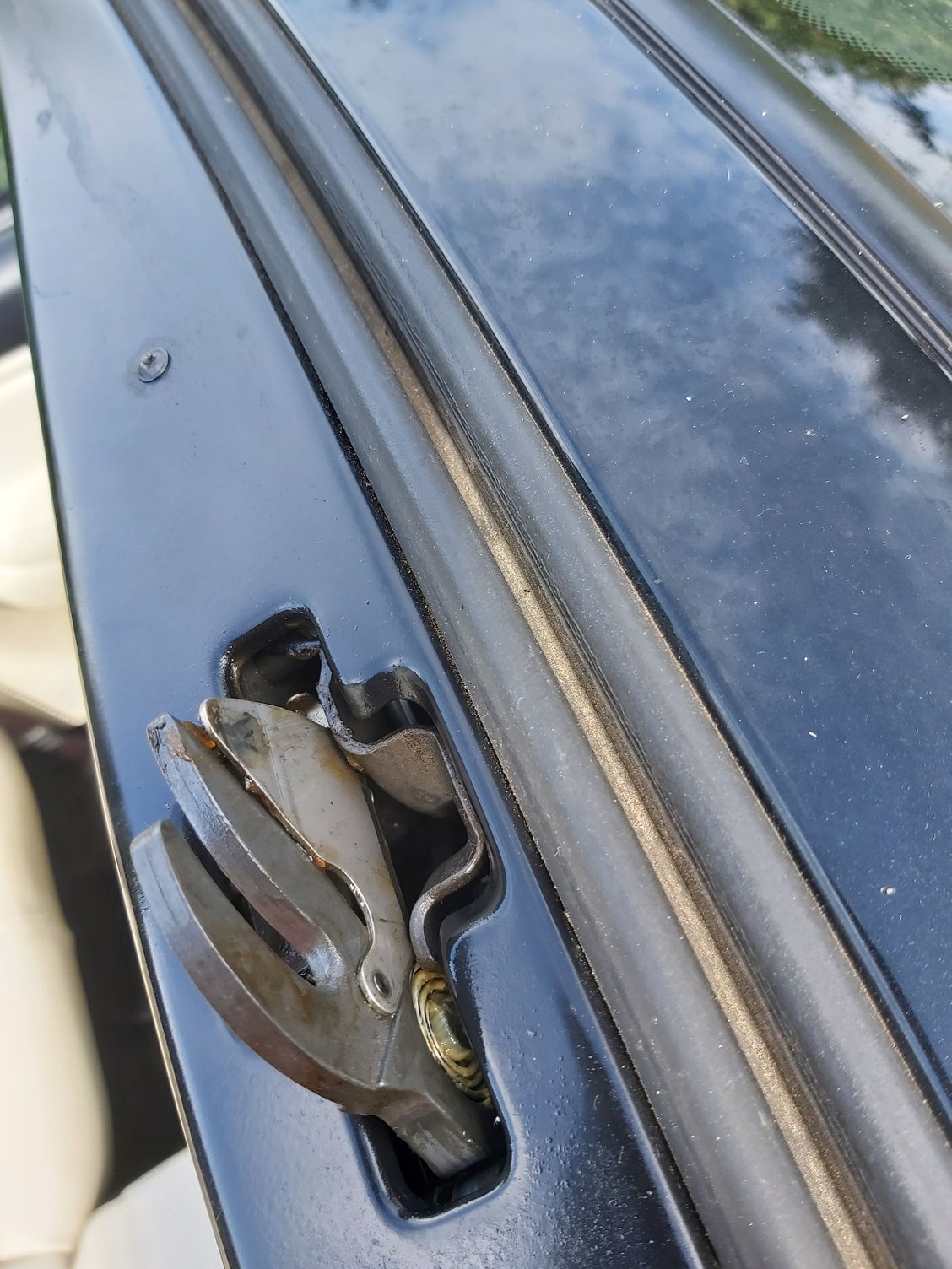

roof had been working fine two years then last week message on dash said latch not closed roof was open so pulled over closed roof on button
Now unable to open on advice checked levels on fluid on bottom line so changed all fluid
I then used Allen key to open latch and clean and oil

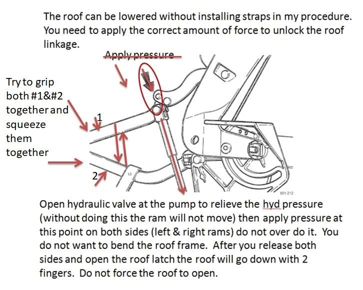

If your windows are going up and down I would believe that your lift rams are in the roof close position so in order to open the roof you will need to unlock the roof lift rams. They are located on the left and right side behind the rear seat and you can see them if you look behind the head liner. This is a picture of the lift rams http://www.jagrepair.com/images/Auto...oof%20Rams.jpg
In order to unlock the rams you must apply pressure down as illustrated in the photo. At that time you will be able to open the roof manually. Note; once you do this your rear quarter windows will not operate until the roof lift rams are locked and that is not easy to do without doing it electrically. They do not lock with a manual closing and latching the roof closed.

In order to do the hard reset for the roof I found it is best to do it with the roof open and the latch parked/closed. Be sure that the petcock is open.
Yes it is difficult to unlock the rams but it can be done with a little extra effort.
Once you get the roof open you need to check that switch lever in the center of the header and make sure it is moving freely use WD40 to free it up. Do the hard reset close the petcock and close the roof electrically. When doing this do not let up on you roof switch until the roof operation is done. Off and on with the switch is what confuses the roof operation.

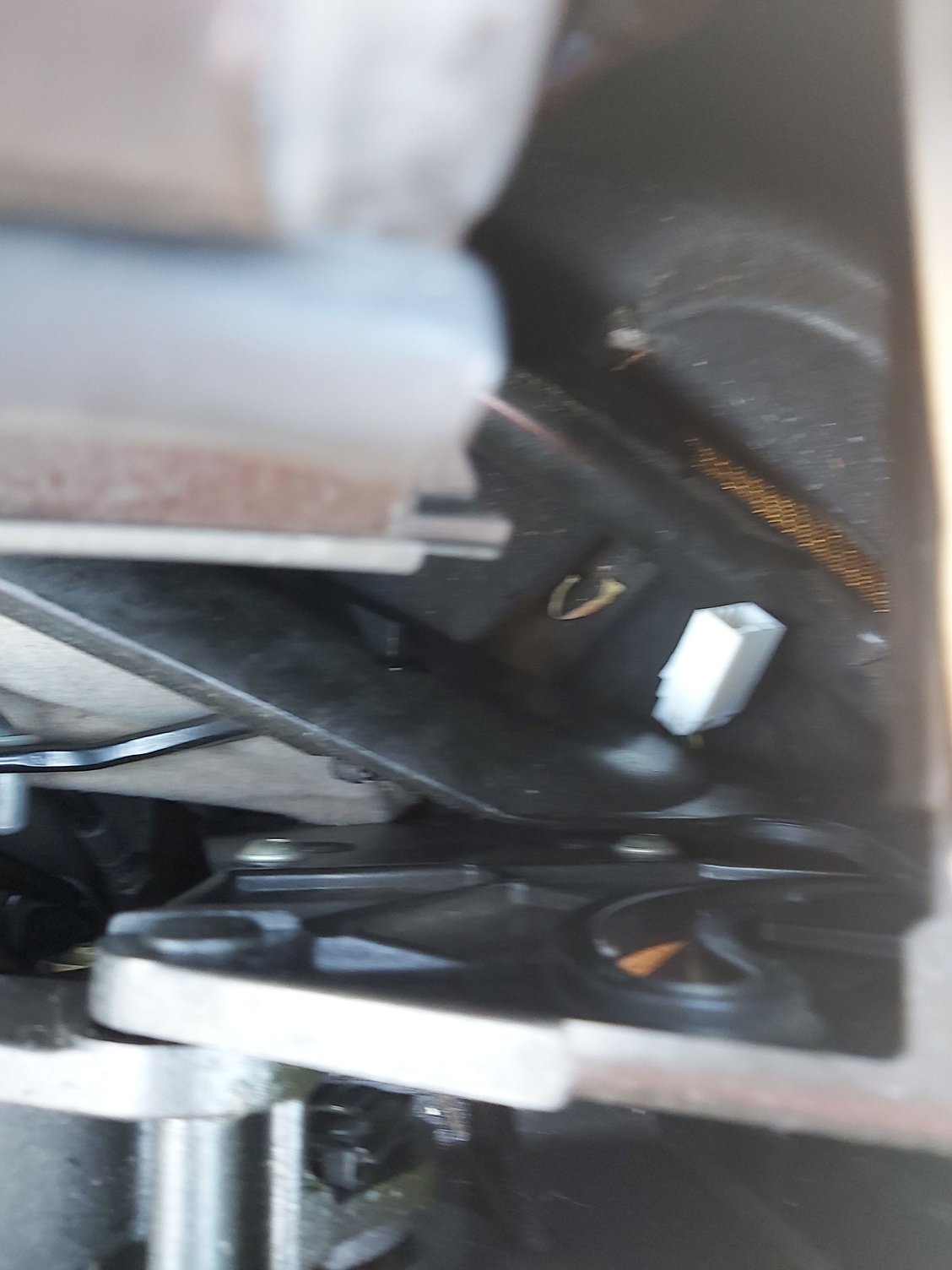

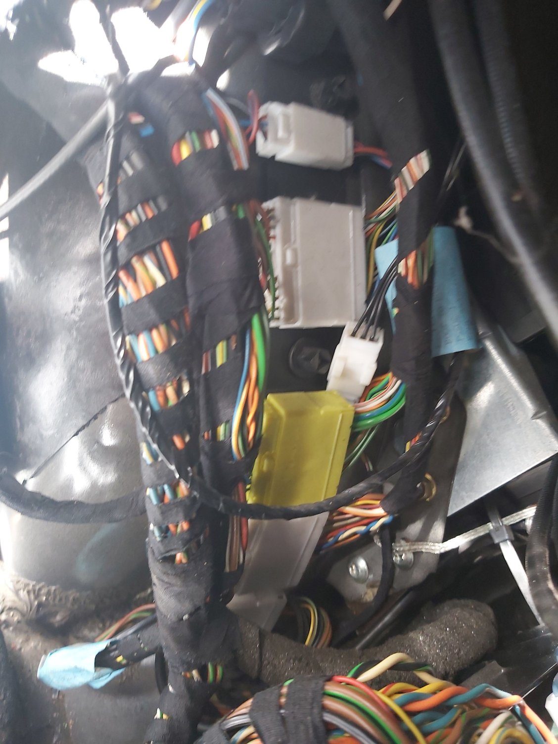

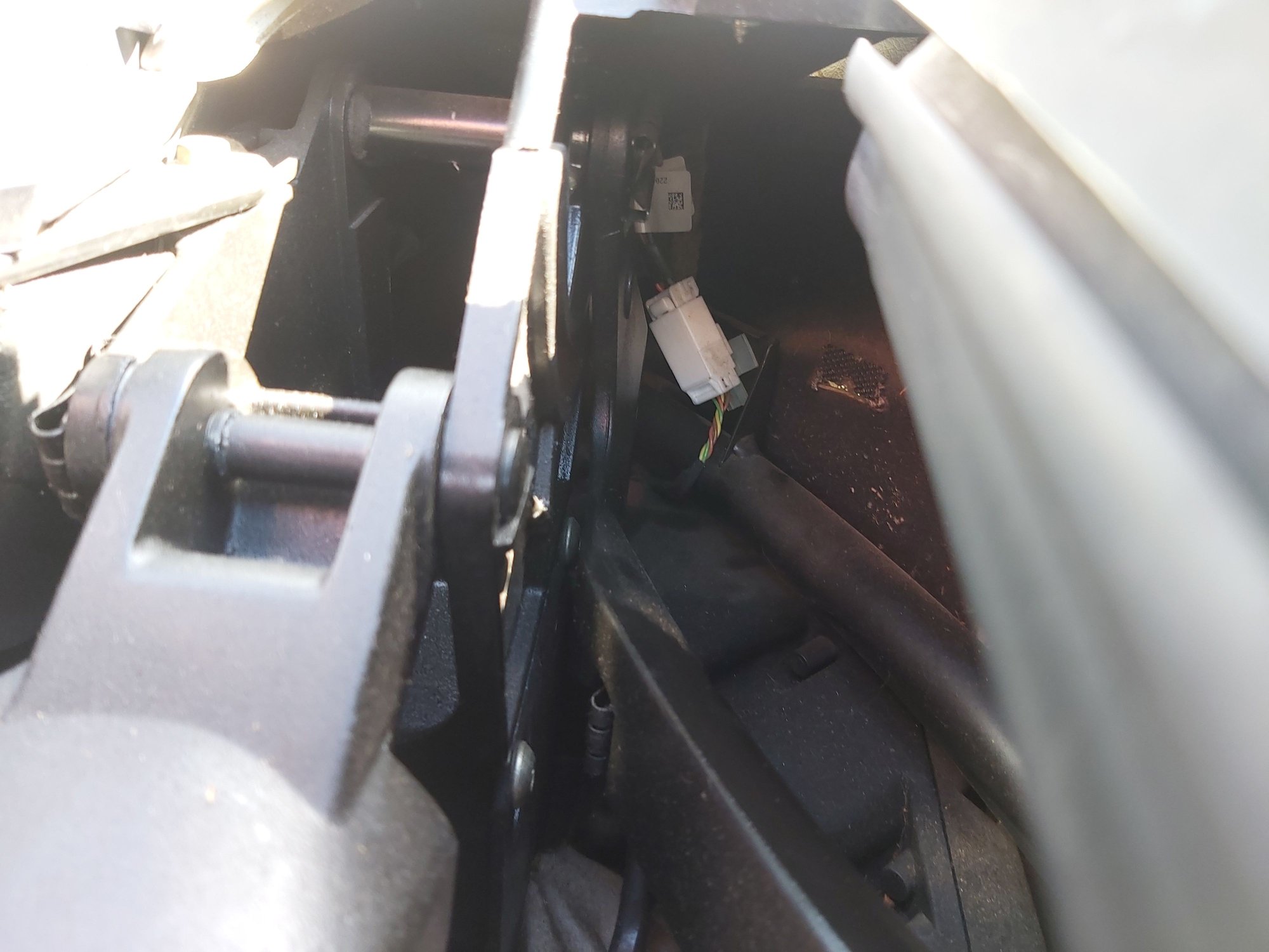

The roof as you said went down really easily started to wd40 all moving parts noticed electrical plug not connected thought that might be problem so investigated could not find other plug the other side is connected did find wire no plug and sealed closed.
So continued with hard reset after did plug on pump tried roof on switch nothing windows went down no noise at all
reset radio and closed windows back ones stuck down

Loose plug ??
Plug other side fine
Top catch cleaned and oiled
Took these photos
