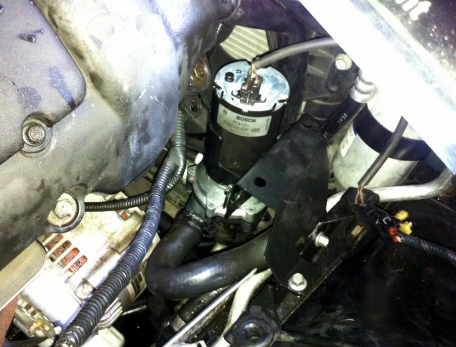

I installed Toyota pump from Prius's power converter cooler and it turns on along with ignition. See picture of me ziptying it on.
Not sure about power difference, since I only drove this car for few days, after I bought it.
Also, I just got my awesome "swedish" pump from SL63 AMG show up, so she will go in today, before I hit the weekend roads

I got that big booty AMG pump in! Dry it revvs like a jet engine, but rather quiet when wet. Also, motor in it is a lot larger, so I had to remove rubber sleeve that went around original pump. Other than that, compressor cooling hoses are now ice cold, when I pop the hood, after getting to work.
