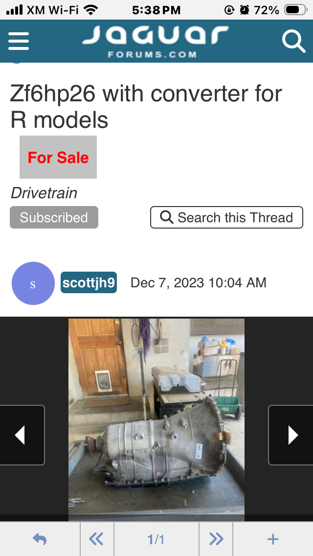

I still have this. It is in the marketplace under zf6hp26 trans. It came out of a xkr
if you want more info contact me.

Old Mar 7, 2026 | 10:57 AM
clubairth1's Avatar
Community Influencer
Posts: 12,189
Likes: 3,406
From: home
That would be a great used replacement!
