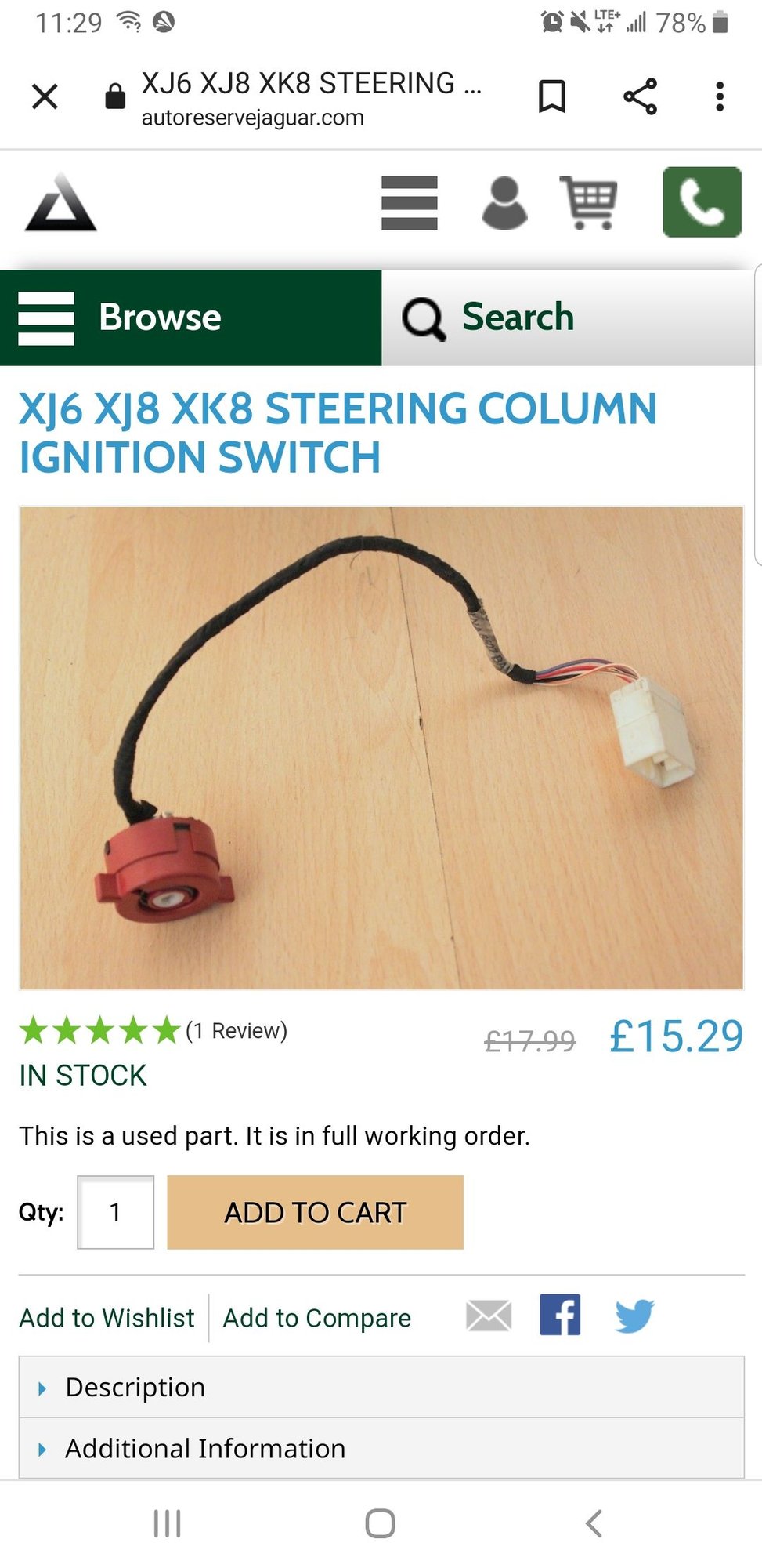

Not sure if this is the part that you'd replaced (title of post) but there is a little gizmo pictured below that is the actual THING the key turns to engage and disengage the various positions when going through position i,,, ii,,,, and iii... The barrel and tumbler will STOP the key from turning when locked if the key doesn't match, BUT if the key matches and the red thing below is defective,,, well, you get the idea...
There is a little shallow notch in the gizmo below that accepts just the very tip of the key for turning on/off and everything in between.
Yep, replaced that twice now and no luck.
