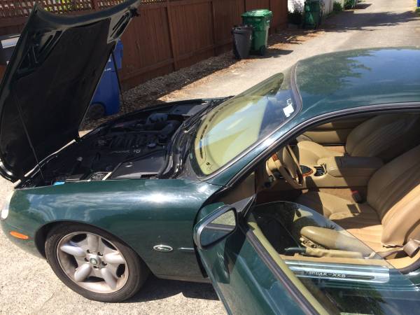

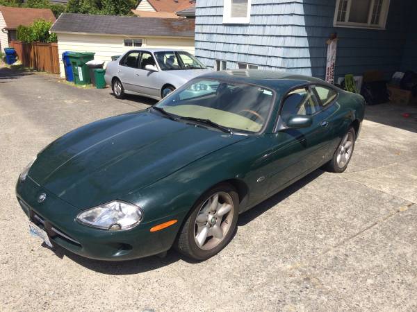

Thanx for the headsup. Had a look at it and this car is starting to seem like the deal it appears to be. Good motor, body, suspension, and interior (except headliner & seat bolster wear).

I think you're right, it may be a deal. Especially if you provide the labor.

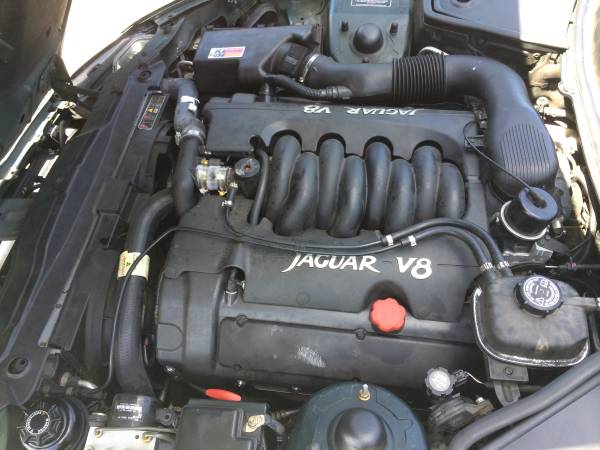

Some evidence of coolant overflow on the expansion tank and the bypass hose from the thermostat tower looks like an aftermarket piece. Better check for signs of overheating. These aluminum motors don't do well when they get too hot.

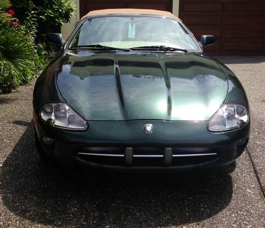

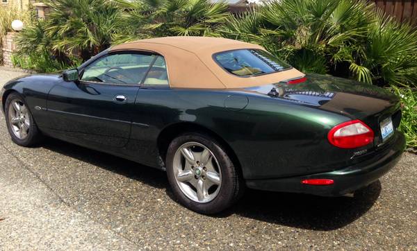

OK, right after taking a good hard look at a good hard look at the Coupe, a Convertible of the same year & color came on the local market with a blown motor bu transmission that was rebuilt less than a year ago. Looks like I'm going to purchase both of them and swap the motor from the coupe into the convertible then take my time rebuilding the bad tranmission and motor to put into the couple. I'm getting both vehicles for $4000 total, ($2000 each). WooHoo!
