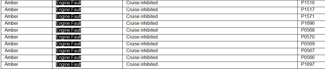

Here is the list from jtis for 97 engine fault amber, sift through these:
I know you said you had no codes but these trip the indicators
