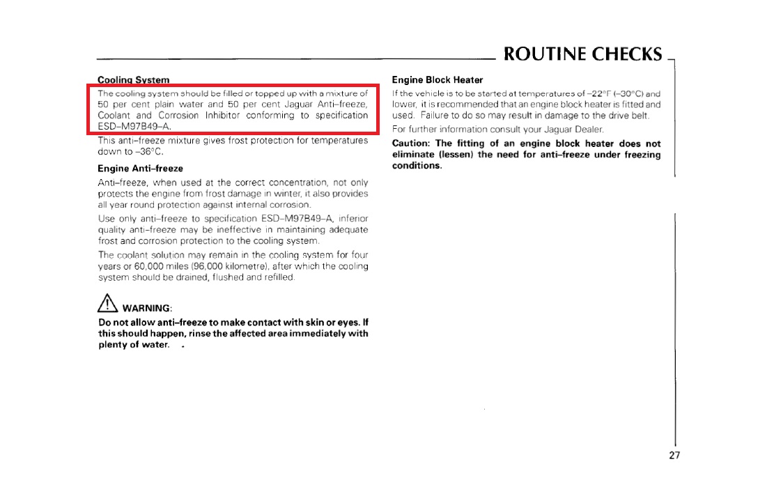

Correct. It's not the colour or brand that's the determinand, it's the specification.
On the container label should be the information that it complies with or exceeds ESD-M97-B49-A
This is a Ford standard so you can avoid going to a Jaguar Dealer.

Oops. Did I say color? Meant specs.
Graham is correct (as usual).
