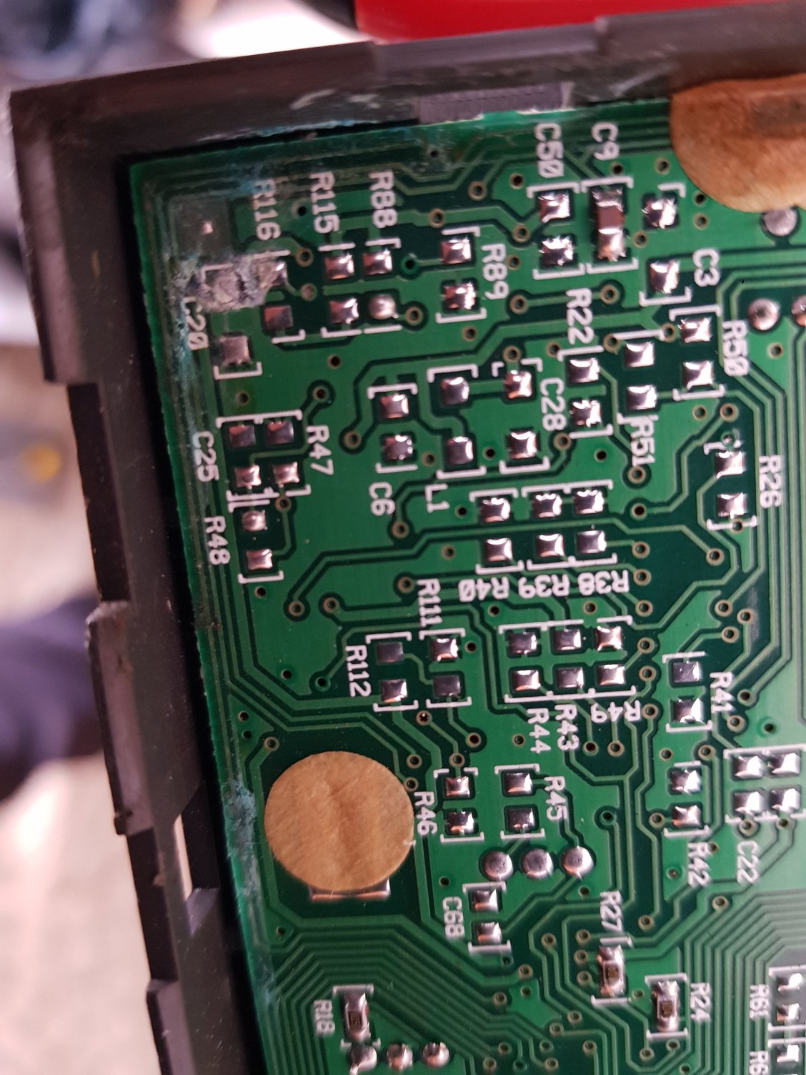

Some of those issues indicate an issue with the SLCM. It is placed on the boot floor and could have got damp/wet inside.
I suggest that you disconnect the battery as soon as possible.
Remove the security module from within the boot fusebox, open it up, and check for any signs of water getting in. Report back with what you find.

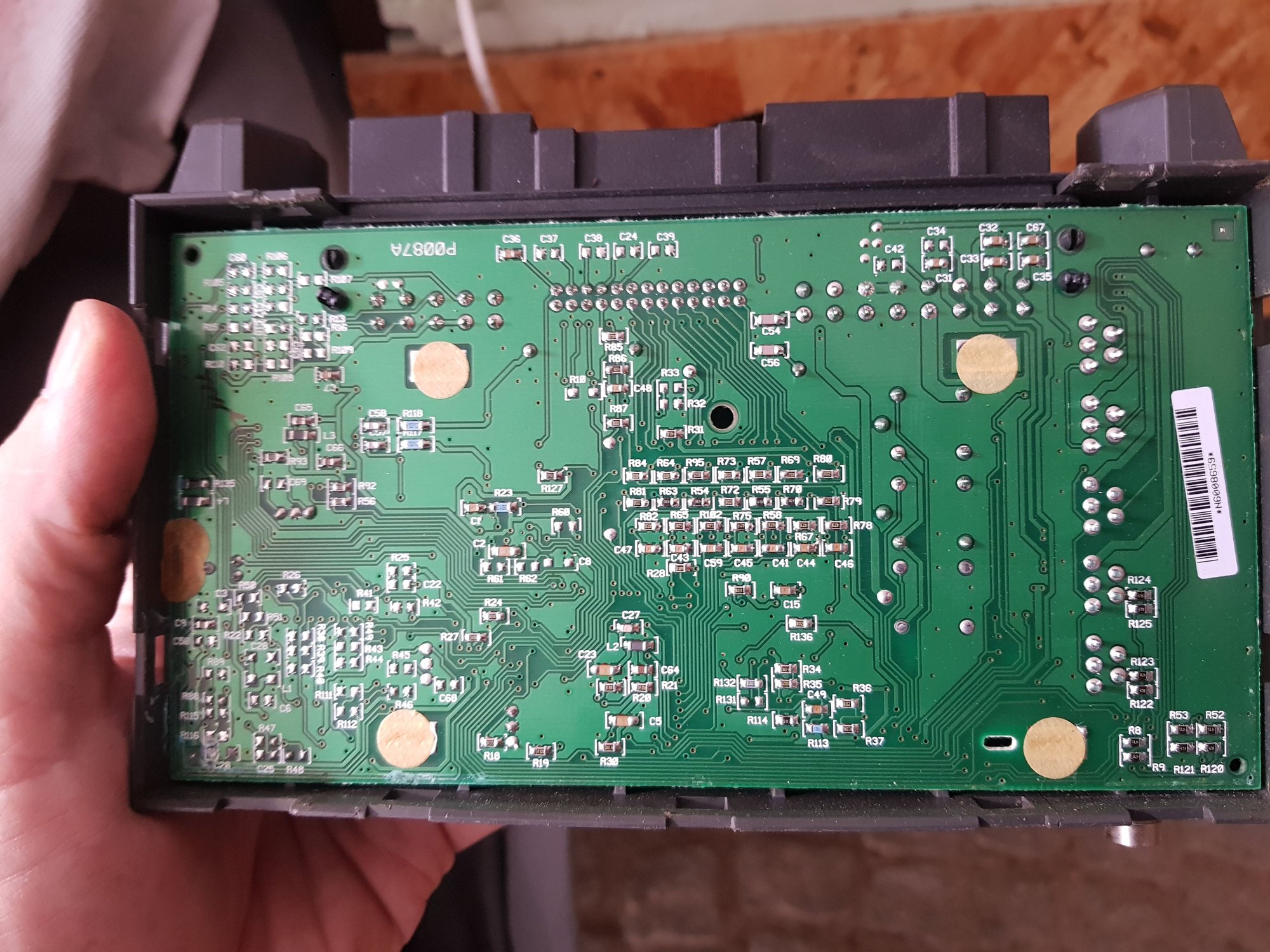

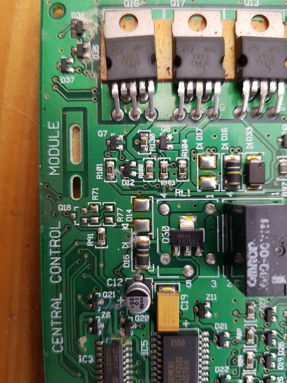

Water damage indeed, but that looks recoverable.
Clean away the corrosion as best you can, using a toothbrush, cotton buds and some isopropyl alcohol. Now that it's not powered, you can even use a rag moistened with distilled water.
Once it's as clean as possible, leave it in a warm place for a day or two to thoroughly dry out before trying it back in the car.
Good luck - you may well have caught it in time.

So my friend who works with small electronics cleaned and checked the circuits, said everything seems fine. But after reconnecting it didn't change anything. Is there a fuse connected to this unit ?
