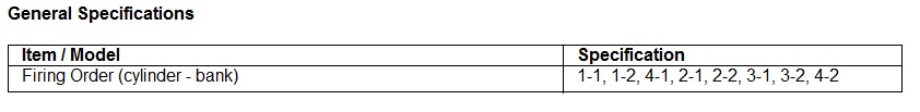

Can't find triangle indent on flywheel, cant get locking tool to fit, can't fit heads back until I know. need to know fireing order

From the web. It is also in the stickies on the main forum page in the DIY section.
Old Mar 2, 2014 | 01:15 PM
From JTIS:

DO NOT TRY TO SET CRANK/CAM TIMING AT TDC!!!!!!!!!!!!!!!!!!!!!!!!!!!!!!!!!!!!!!!!!!!!
The oval timing slot is the correct segment to line up in the CKPS mount hole.
The top and bottom of the slot is ROUNDED.
The firing order will not help with cam/crank timing.

Thanks Bob for the warning, when I finally found the mark and no pistons were on top I thought that can't be right but it was the only place that the locking tool would fit. I then realized that that the timing was built in (as it were ) to the lock and cams. No timing lights and marks like the old days. Total disaster though as when I checked the exhaust valve clearances they anywhere between .008 to .013 + back to the machine shop and another or more weeks lost. I had not installed the heads yet, that was a good thing. I had a valve head break off years ago on a mark 2, too much valve clearance, took out the whole engine, don't want that again. Thanks again for your help
