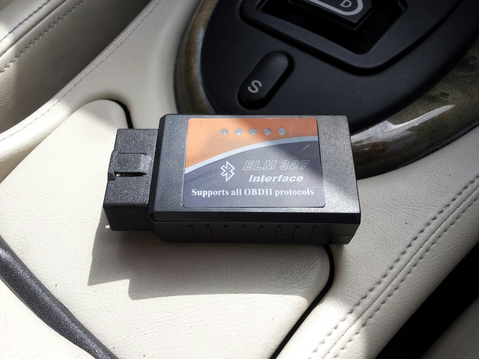

Old Jun 11, 2013 | 07:30 AM
JagTheRipper's Avatar
Joined: Jun 2011
Posts: 180
Likes: 16
From: London
Mine looks like this:
Attached Thumbnails '99 XK8 Restricted Performance and more..-20130608_152524_resized.jpg
Old Jun 11, 2013 | 09:33 AM
steveinfrance's Avatar
Posts: 6,278
Likes: 690
From: Limousin, France
Mine too (it's OK to compare dongles on the Forum, within reason!)
