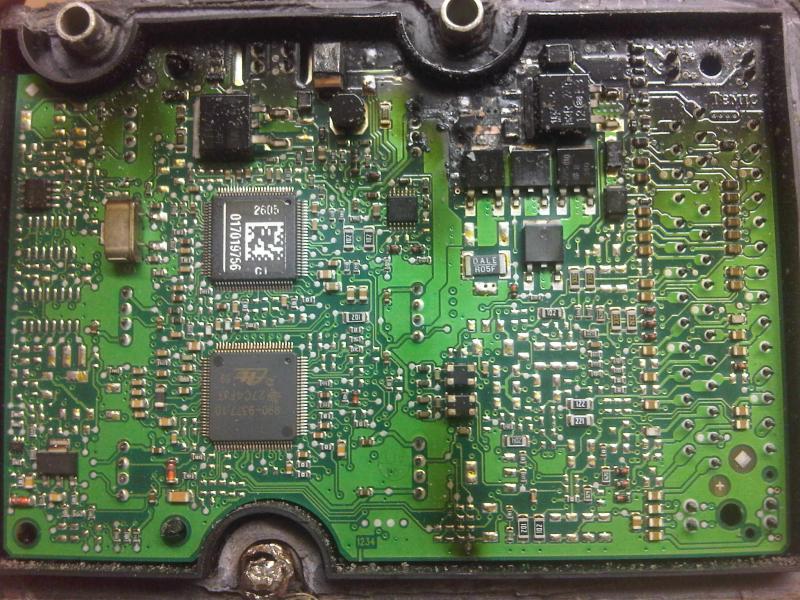

I did open the unit and this is what I found. Components blown off the circuit board. I have no idea what has caused this. I have found out that the correct module part number to be C2N3651 to fit 03-05 models
I think the module is beyond repair.
Has anyone had this before and know what the cause is?
Is it possible the motor on the ABS could have seized and overloaded the control module?
