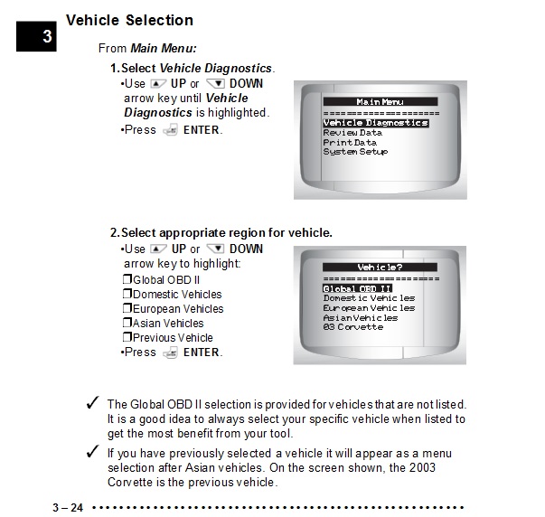

I've downloaded the User Manual to check how to set it up.
In the Vehicle selection menu go down to European Vehicles and press enter.
If Jaguar is not listed then follow the instruction at the bottom of the page regarding the Global category. Go back to the Vehicle selection menu screen and use Global OBD11 instead.

My CP 9580 works fine on my 2000 4.0 liter. After selecting Europe, It asked for Jaguar and the year and after selecting 2000 it only listed 4.0 liter
If I "Lie" and say it is a 2003 XK8, it shows a 4.2 liter.
It then saves the Info and next time you use it it will Show saved vehicles to select from.
The Software version on my Scanner is 4A14 (Main Menu, System Setup, Tool Information)
Also: Your 2002 should still be a 4.0 Liter.
