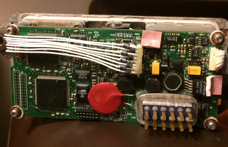

There is certainly no harm in cleaning the connector like that, in fact it is one of the basic steps in this kind of fault finding (along with checking fuses etc). Unfortunately those modules have a history of failure, no doubt due to their exposed location, and new ones (and even working second hand ones) are impossible to find. You could open the module up to look for anything obvious that has failed:-
Wow! It looks scary in there.
Yep. State of the ark now, but pretty advanced back then. I wonder if anyone has tried getting a faulty one repaired? Lots of simple components in there that can fail.
