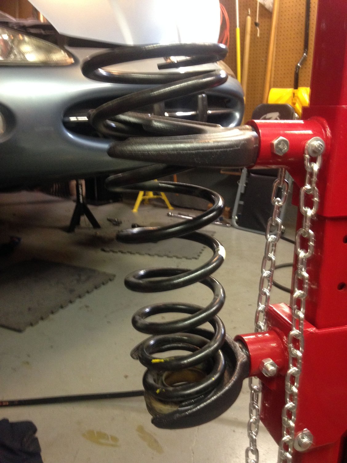

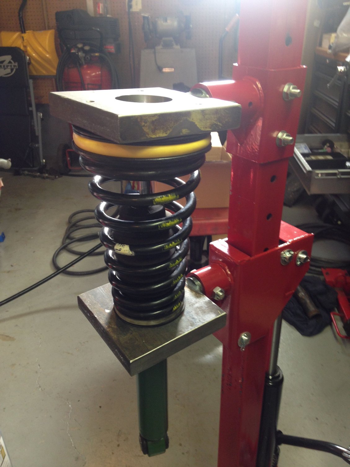

You guys continue to be the BEST, most helpful people on the internet forums. I have done my front studs already and may take the advice to get rear top mounts to have on hand. I've been way to busy with other things to give Kitty the proper attention she deserves. I won't bore you with moving stories, Probate court (brother passed in Feb.) still working etc. But she waits patiently til I can take a drive. Going to Cars and Coffee myself this morning near me in the Cincinnati, OH USA area.
So, having said all that, I have a killer strut press with attachments JUST FOR the XK8 struts. I am dying to help someone out near enough to come to my place or go to yours. I have received and read so much good advice from so many I feel I need to contribute something to say thanks. So someone who needs to rebuild struts contact me and we'll work out something. 10 MINUTES!!! I swear ( though no swearing is proper on the forum) that's how easy it is. AND safe, No springs flying across the shop. TM
This is the good one!!  It pays to have a machinists friend.
This is the BAD one!! In fact, I scrapped those attachments.

TM, I did buy that machine and it was never going to work on a Jaguar XK8. Made the plates you have but only had the thin 1/4 inch and it was going to take my head off. LOL
Thanks you for the offer to help in your area, I try to do the same.
