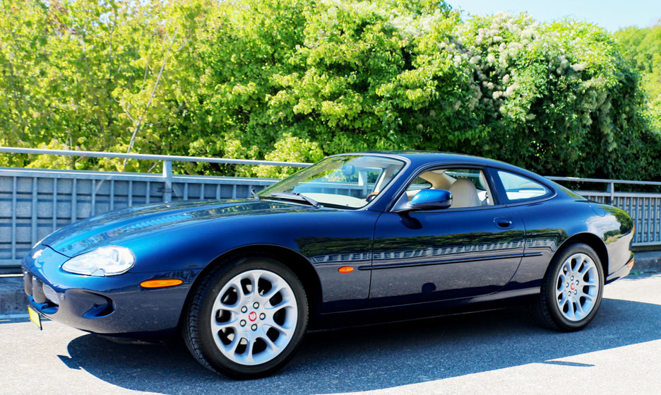

Hi all, long-time lurker here; currently considering a 1998 XKR S/C to replace my DD which was stolen a few weeks ago. The car has roughly 80K km, seems in good shape from a superficial inspection (no rust, no uneven tyre wear, etc ..) handles well (even though I have not taken her above 90 km/h so far) and the dealer is willing to pay for a Jaguar inspection + maintenance prior to buying. I've always loved the lines of this car and my budget allows for the necessary maintenance costs etc., my wife gives me free reign in choosing my car and so all should be great ... however, a small part of me is still nagging on the fact that this will be my DD. Any advice, thought, recommendations?

Welcome to the forum David,
I've always used my Jaguars as DD's and only needed the services of a recovery vehicle twice in over forty five years.
Have at look at the FAQ's 'sticky' at the top of the thread list for regular issues with this model. There are three areas to consider:
1. plastic timing chain tensioners (must be replaced with later metal type)
2. transmission fluid changes (not in the service schedule but highly recommended to increase unit life)
3. cooling system - early water pump failure/ plastic components
An excellent model and not difficult to maintain for a DIY'er. Can get expensive if you intend to use dealer or independent.

A few other things to look for on a 1998:-
1) That is still the era of the Nikasil engines - I would want to be sure the engine is ok.
2) Suspension may well need a rebuild as all the rubber bits will have dissolved over 20 years.
3) Rust. The OP is in Geneva, which I assume means salt on the roads in winter. A 1998 could look great on the outside, but could be a complete rust bucket underneath. Plenty of threads on the subject and what you need to look out for, including rotten footwells.
Finally if you can live with 20mpg as a commuter car (less around town) then you will end up with a great car for the purchase price.

That is one good looking 98 Coupe.....Haven't determined the color but it looks really good and the Wheels are excellent. (Double-Five of something like that) Looking as good as it does and with the low mileage (for almost 20 years old) and it appears they are asking a good price for it, as they are willing to pay for a few things to make sure it's in good condition.......seems like a good deal......but remember, it is 20 years old and you need to do the things that Graham has indicated before you drive it very much....Those things are very important for that model of Jaguar. If you don't do them, then you want have it very long......Spend about $3,500.00 on it and you will have the Jag for a long time.......and the best thing about it is that it's a Coupe....You'll love it!
