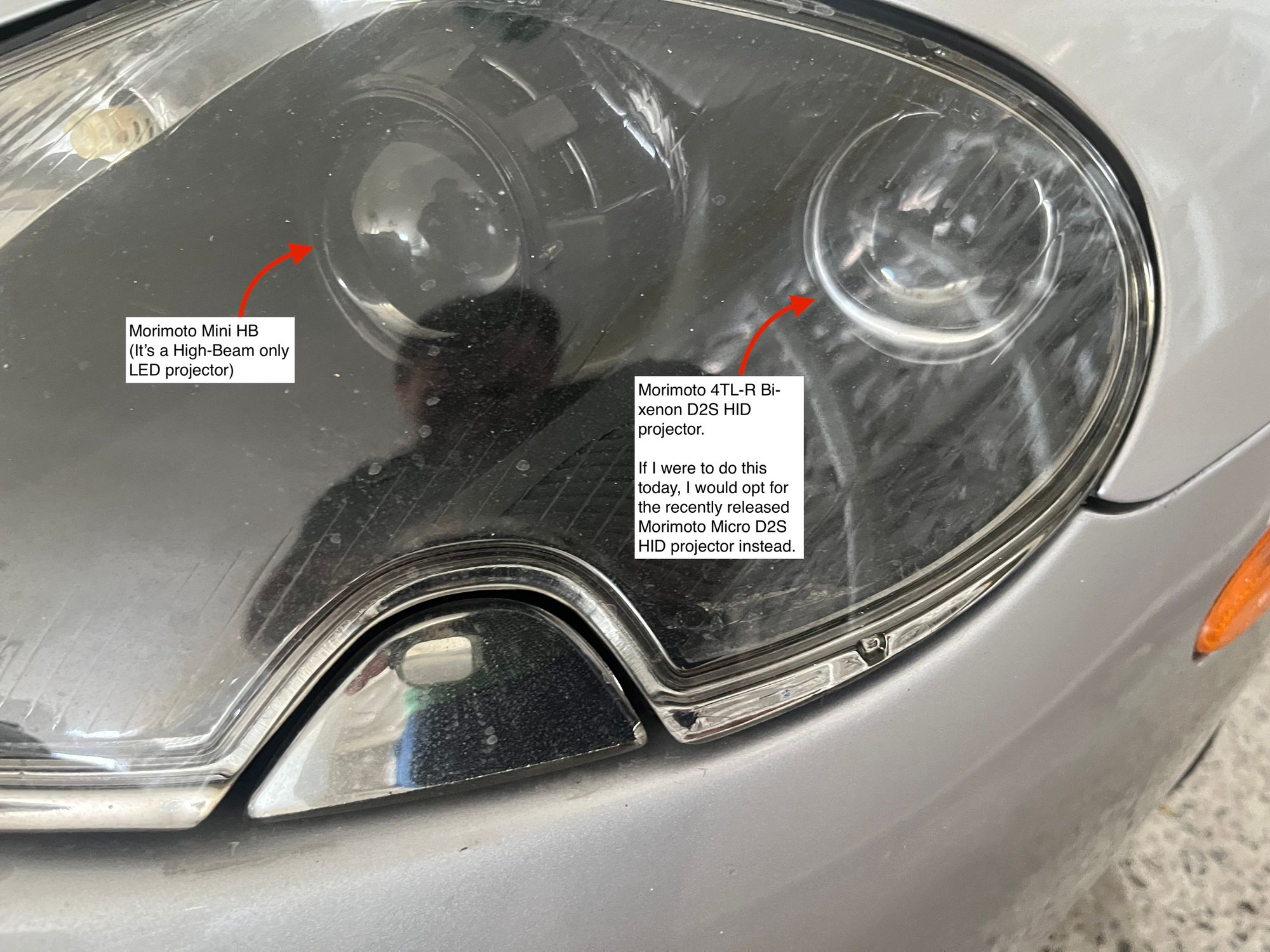

I don't have superbright LED bulbs fitted in my car. My car came with the factory HID headlights. The OE HID projectors and the Halogen reflectors were burnt out, providing sub-par light output. I modified my headlights to replace that halogen high beam reflector to instead use a high beam LED projector, and the low beam I installed a Bi-xenon HID projector. From the wiring harness, a y-split 9006 wire connects to the LED high beam projector, and the bi-xenon's projector cut-off shield solenoid. That way, when I activate the high beams, both projectors are outputting in high beam, but, when the high beam is switched off, the cut-off shield stays in place focusing like light beam in low beam mode, and the High beam projector is turned off. The result is that I have great light output at night. I've been running this setup for a few years. It is leagues better than the OE HID system and any LED bulb or halogen bulb that you can think of. For my HID bulb, I am using the Phillips Xtreme Vision bulbs instead of the cheapest HID bulb you can find (they do make a difference). However, my setup requires hacking into the headlight innards and removing the stock HID projector (which is lousy in design), modifying it to fit the retrofit projector, and converting to a D2S bulb instead of the OE D1S, and also removing the halogen reflector and bolting the LED projector to it.
You can see more info of my build in this thread: https://www.jaguarforums.com/forum/x...jector-240281/
Now here's the thing, I retained the OE Valeo LAD5G projector because it interfaces with the ride height sensors to provide the adaptive headlight function. This adjusts the height of the beam as you drive to reduce glare to oncoming drivers. However, this means that I'm still running my HIDs using the 30w system. If I wanted to upgrade to 50w, I would have to sacrifice this function but would end up with even more light output. I'm just wondering if the difference is enough to justify it? Since I'm now getting flickering from my ballasts, the time is coming for me to replace them. So, do I keep the stock ballast or do I upgrade to a 55w system?
If I do upgrade to 55w, is there a risk of frying my wiring?
Also, if I'm going to have to remove my headlights to replace the failing ballasts, I might do what enderle did and installed a pair of LED halos in each headlight to have DRL function. The nice thing about some of these halos is that they allow you to also be controlled by the turn signals, giving you amber LED halos flashing when the turn signal is actuated and the white LED halo when it isn't. I just worry that that may look too BMW-like with my quad-projector setup.
